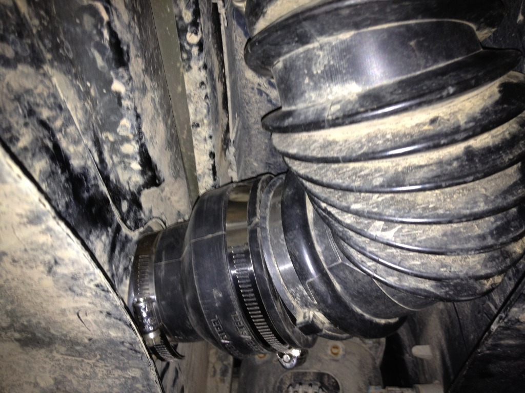

Yes I am putting an ARB on. I think Hunner gave me an idea for a solution using silicone hump reducers unless you have a line on one.

You can go Hunner's route... OR...
There's a 3" to 2" reducer there (check local hardware store if you don't need top of the line) and a modified 3" 90 bend (cut off approx 4" 2" each side) AND the stock intake hose after the MAF! Re-use what I already got!

Looks great Dan! I am still a little confused what you hooked the 2" end to. I think maybe because you have the Air Doc you set-up at that end of the air box may be different than mine. I only have a 3" spectre tube in place of the stock "snorkel" so I have a bit of a gap to deal with and nothing on the outside of the box to really make the attachment. A 3.5">3.0 boot should take care of that I think.
