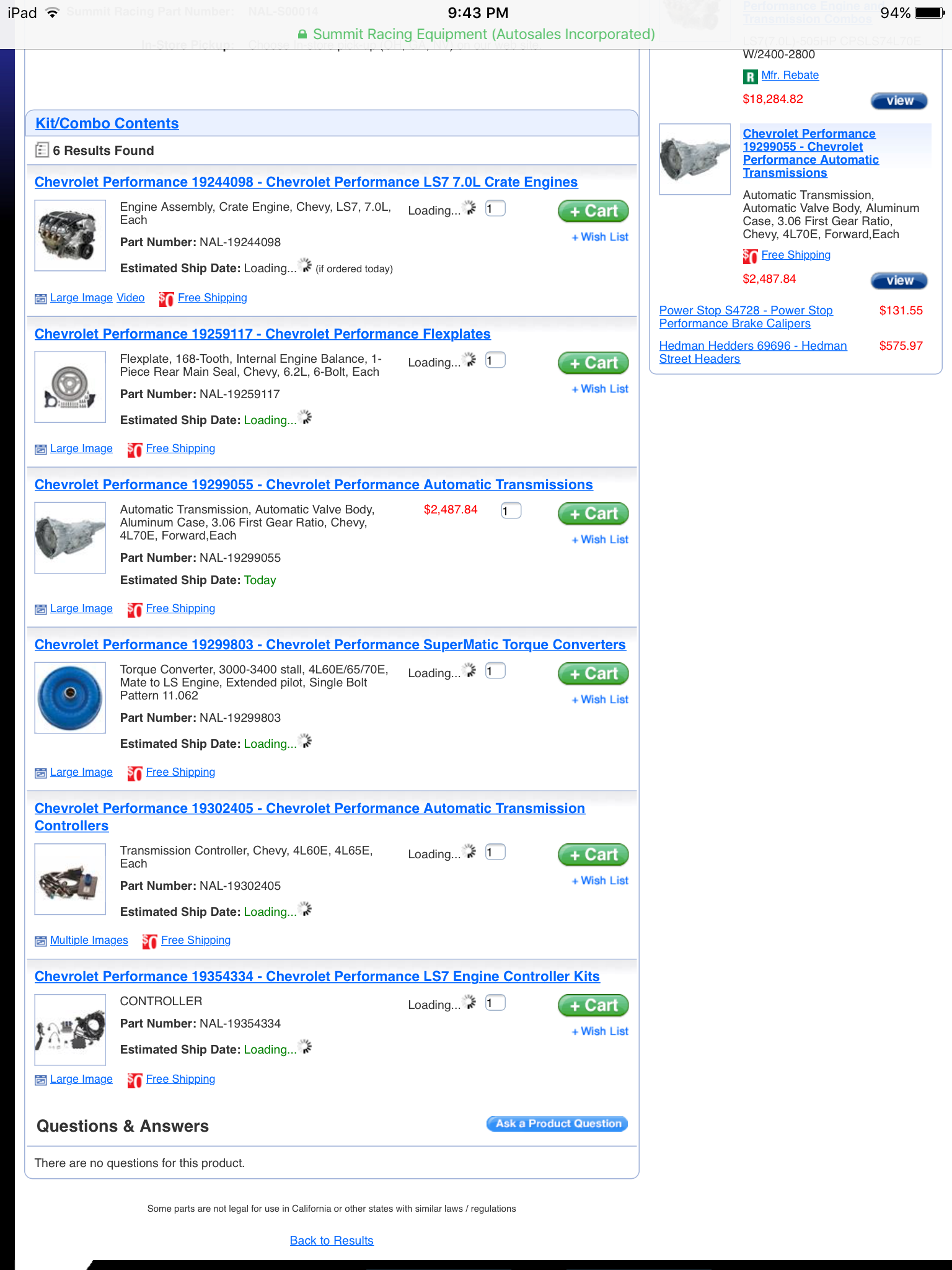

Would this work in the h2?
All the talk up dmax upgrades and the ages of some of the h2's- mine is getting up there. 13 years old 126k. I am thinking about when she finally gives up the ghost- what all are my options. I know my 03 is the smaller motor and crappy tranny. Would the stuff in the pic work? Just out of curiosity and wasting time before turning in for the night.

I found the same engine with a 6L90 transmission. I am in no way impressed with the 6L80. I think it's garbage, lol. From what I've read, the 6L90 is just a heavier duty version. You know we need something overbuilt with the weight of the H2. The 90 is a hair longer, but there's always a way to make something fit. Also consider that the 6L90 is rated for lower power diesels (300hp/520ft-lb), but can be overbuilt to accomodate more power.
CPSLS76L90E - GM LS7 505HP Engine with 6L90E 6-Speed Auto Transmission Combo Package.

The LS7 engine that you listed would not be a good fit for a heavy deuce. You need something that is more torque biased, and not horsepower biased.
Like Synkiller listed you could also get an engine/ trans combo with the newer 8 speed trans.
