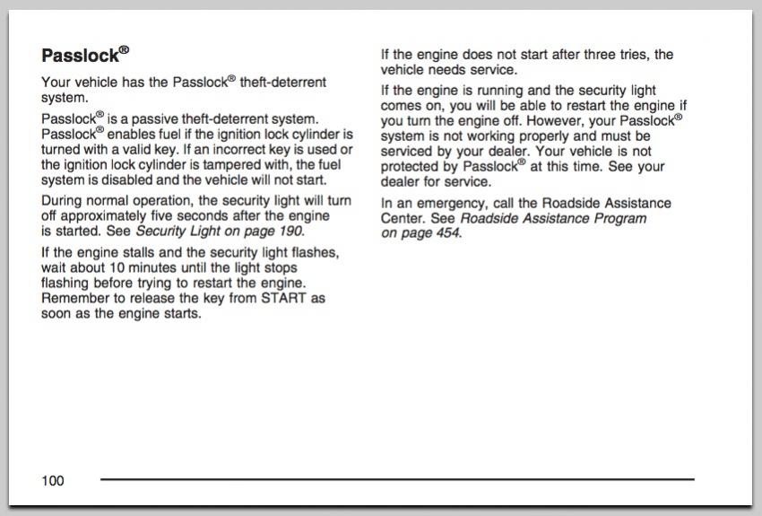

I agree with Draketh, if as you state the security system light is flashing on your dash, you may have the system engaged and not allowing you to start. Before you start buying parts, check that out first.

Read this from the manual about pass lock
Attached Thumbnails Won't start after new battery D:-pass-lock.jpg

I agree with tom, don't go banging on things. They don't like it. Your probably dealing with the passlock system or you popped a fuse changing your battery. Most likely a fuse so I would re-check what you did very carefully.
