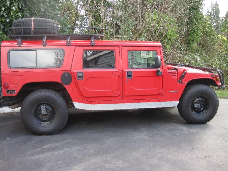

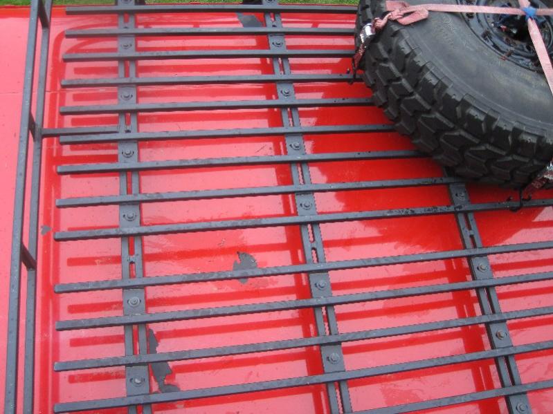

Here are pictures of the rack, I'm not sure who made it.
Attached Thumbnails Will my H1 roof rack support the weight of 4 wheels?-mini-img_3448.jpg   Will my H1 roof rack support the weight of 4 wheels?-mini-img_3484.jpg
Old Apr 20, 2012 | 04:27 PM
That looks like one of Joe Toth's old racks. He made the original OEM racks. They aren't supported as well as some of the later racks that have the "legs" that wrap up the roof line. Rule of thumb is 300#s but lots of people have far exceeded that. I would carefully place them on the rack and secure them well so they don't slide around. Your 16.5" wheel/tire/runflat combo weighs in at around 165# each. I used to sleep in the back of my old 97 wagon on hunting and fishing trips. Just have to pull the cargo divider out and you have plenty of room.
