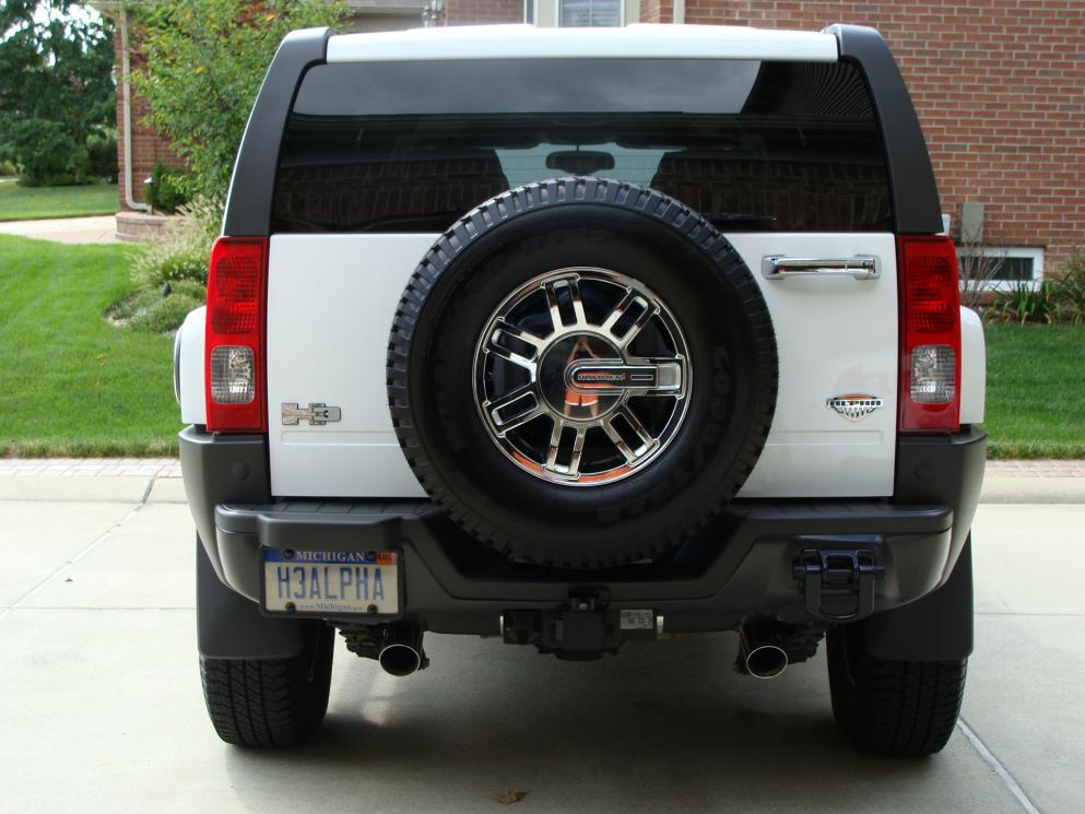

I don't have my Alpha leveled, and don't care to, so the torsions are in factory positions. Just got done washing it, and noticed it leans towards the driver's side. Got out the tape measure, and sure enough, drivers side rear at 24", passenger side rear at 24 7/8", both fronts at an even 22". I thought about trying to crank the driver's side to level out the rear, but then I'm sure I'll throw out the front. I currently have 5/8 tank of gas, so it will only get worse with a full tank. Any thoughts?

But seriously, these trucks came with all sorts of measurements from the factory. No two HUMMER measurements will ever be the same. No, cranking the t bars wont lift your rear-end any.. but if you think about it, you will be lifting the rear end several inches.
If you think about the truck as a lever, think about how the front is 2" lower than it should be.. think about every inch of frame you get to being closer to the rear tires. Every inch on the front axle, will lift the middle of the truck even more so. Does this make sense?
So in short, no you the t-bars doesn't exactly "lift" the rear-end.. but it does in-fact lift everything in between the front axle and the rear axle by more than 2".

I have noticed on a few of my Alphas that there was a difference in the rear height from left to right. Once you start to try to even out the rear with the torsion bars your front will be lop-sided and you will need an alignment! It is a never ending cycle!

Not trying to be goofey but make sure you are on a Level surface when you measure. My garage is fairly new however if i dont park exactly in the center of the slab, it will show one side slightly higher. Also if i was you, i would leave your side steps(nerfs if you want to call them) on. not only do they offer a tad bit of side protection with a low speed contact, i use them when washing/polishing or cleaning the sunroof glass or roof not to mention getting in without always yanking on the steering wheel.

It really doesn't matter if the driveway is level or not. As long as it's a 'flat' surface, being off level will have no effect on the sprung distance from wheel center to bottom of fender.
