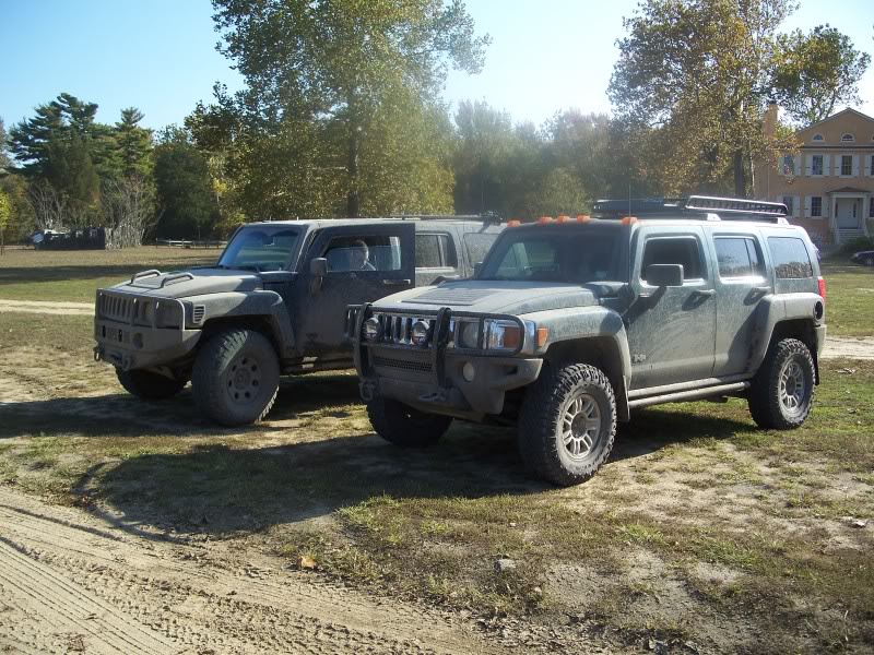

33's on my truck in front mounted on OEM rims
35's on the truck in back mounted on OEM steel rims
both leveled by t-bar crank to 23.5"

Just to make sure we are on the same page, the tires I am selling are not the ones in the picture above. The picture above is of my new, 35” tires.
