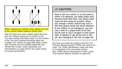

Originally Posted by drtom
the instruction book for my hummer shows a 4 tire rotation,no spare,,,oh whats a mother to do,,,
the manufacturer must know something.
oh,one more thing;those little gears that go around with the ring gear and never turn on the dragstrip or turn pike
they only rotate when going in circles,AND have no bearings!! could be why they say go 50/50 or less on dinky spares. they could get warm in time,,like when i go to pittsburgh
Page 382 from my '07 Owner Manual:
"When rotating your vehicle’s tires, always use one
of the correct rotation patterns shown here."

perfect timing!!i just double checked my book for accuracy,it specifically says "do not include the spare",2010 adv.
i really do wonder just what the xxxx they are doing with the instructions from year to year.
this is not the first "mystery",,,i give up. 5 tire rotation obviously makes sense,,,the book does not. they sound like the gang in dc.!!

Could the reasons for the difference be in '07 the spare had a TPM and the '10 does not?
I was going to ask about that. It's the only reason that makes sense. But why they would cheap out on a $50 sensor...
