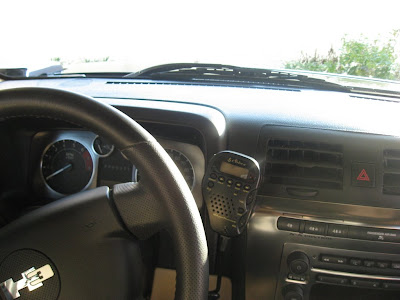

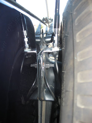

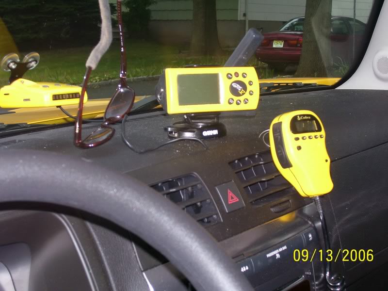

All-in-one Cobra mounted to dash. Antenna mounted to spare tire carrier.

Oooo. Thanks for the pics! Must have been tough pulling the cable through. I am almost regretting the location I chose. The only reason I keep it so low is because the parking structure at my job only has 6.5 feet of clearance. With the leveling kit, I am about a half inch from losing my OnStar antenna. I also took the discarded antenna from my wife's Solstice since it was two inches shorter than the stock radio antenna on the H3.
Good news is, I still have a 5 foot Firestick II that I use when I am on trips so I don't loose too much signal.

Actually, the cable was easy. Ran it through the vent in the back door, drilled a small hole in the plastic near the hinges and ran it under the plastic all the way to the front. For the CB power I drilled a 1/4" hole in the firewall, put a grommet in it and ran the power and ground (pics available for those that need it). The only problem with the antenna mount is that the door itself was not well grounded to the truck so I ran a ground wire out with the antenna and grounded it under the rear door sill.
The quick disconnect for the antenna should have arrived UPS today at my home so that should be more convenient so my antenna (Firestik II, 4') is easily removable when not in use.
