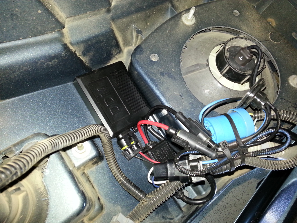

Well this is the only pic I could get from my build thread. I popped the hood for more pics of the wiring but I hide my wiring so well there was nothing to take pics of lol.
DDM used to sell a slightly cheaper Raptor version of their HID's but they don't anymore. All they have is the slim ballast kits with the separate ignitor which I am not a huge fan of.
The ballast is obviously the large black box that says DDM, the ignitor is the smaller black box next to it.
The way you wire in a relay harness is the factory headlight wires act as a signal for the relay. So when you turn the lights on ALL the factory headlight wires does is sent a 12v signal to the relay to close it. This lets the larger wiring from the harness pull the power directly from the positive on the battery/alternator and sends it to the ballast.
Let me know if you guys have any other questions.
