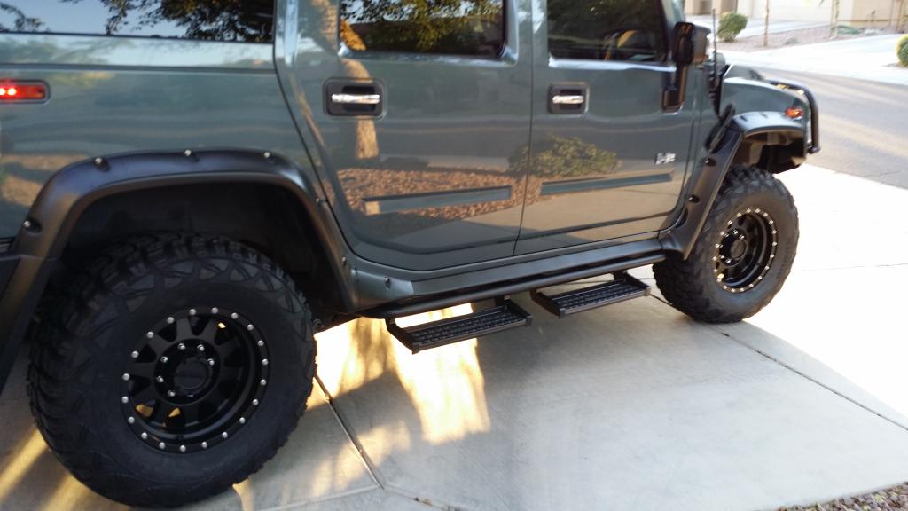

Posts: 2,357
From: Surprise, AZ
I have the E&G offroad flares and I believe my aftermarket wheels are a 4.5" backspace. That pushed them out quite a bit compared to stock but they are exactly in line with the fender flares. I wished I could post you some pics but photobucket is a piece of shat. Click the link for my build thread, see if the pics show up.
just want to verify which is correct. you install thread says "4.25" backspace but here you say "4.5".
Old Sep 20, 2017 | 09:18 AM
LoJac963's Avatar
Joined: Jul 2011
Posts: 2,357
From: Surprise, AZ
Then it is probably the 4.25 since it was done years ago my build thread would be more accurate than my memory

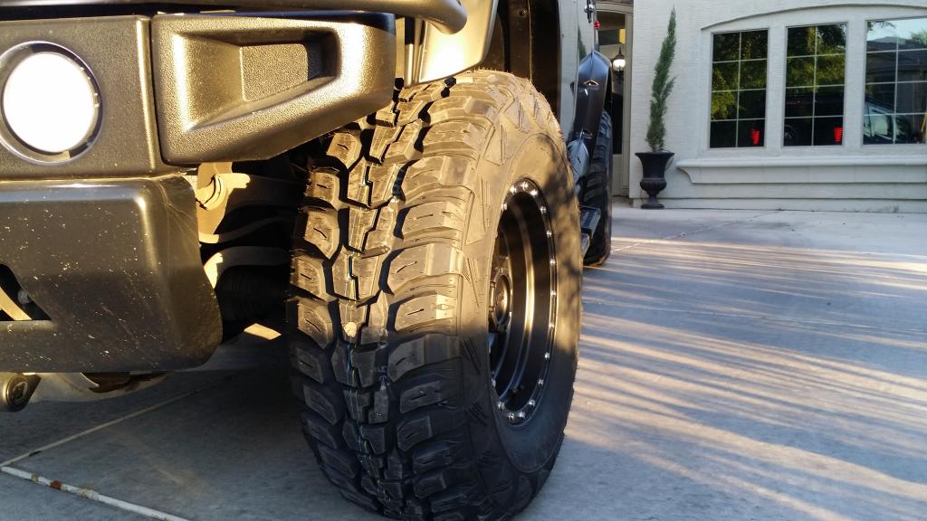

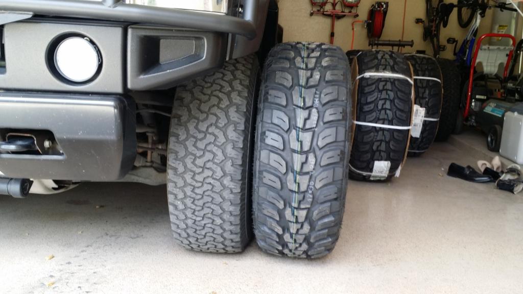

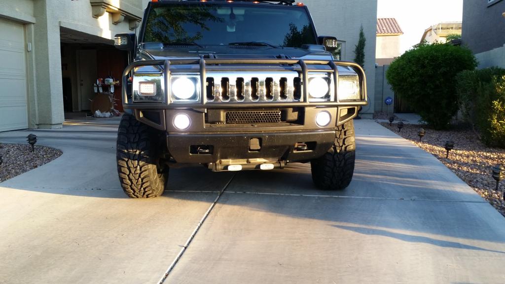

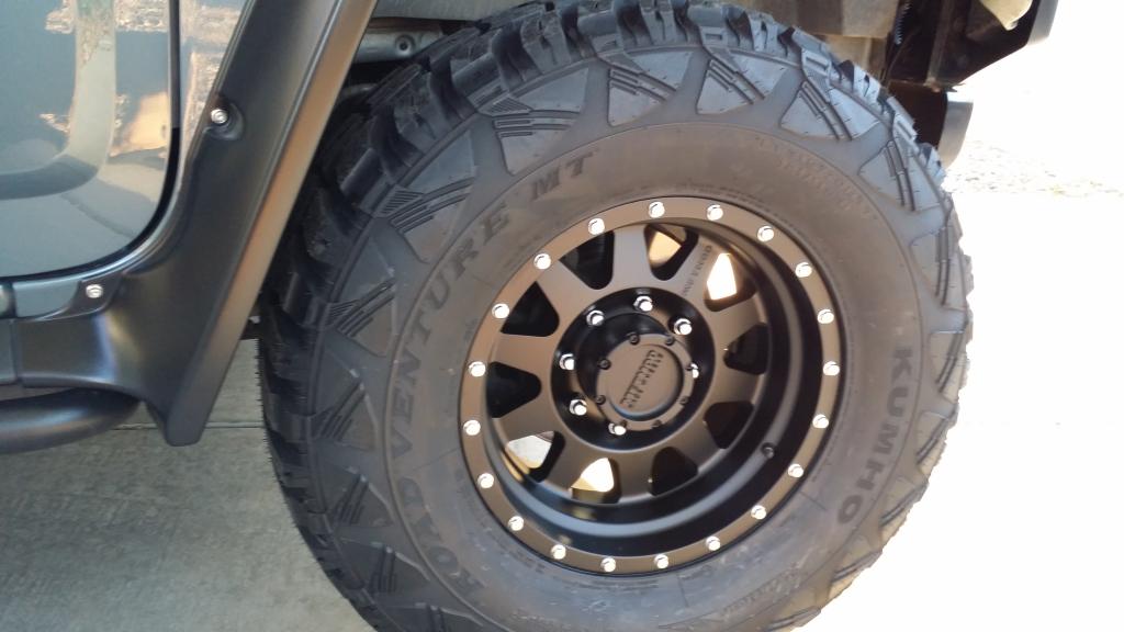

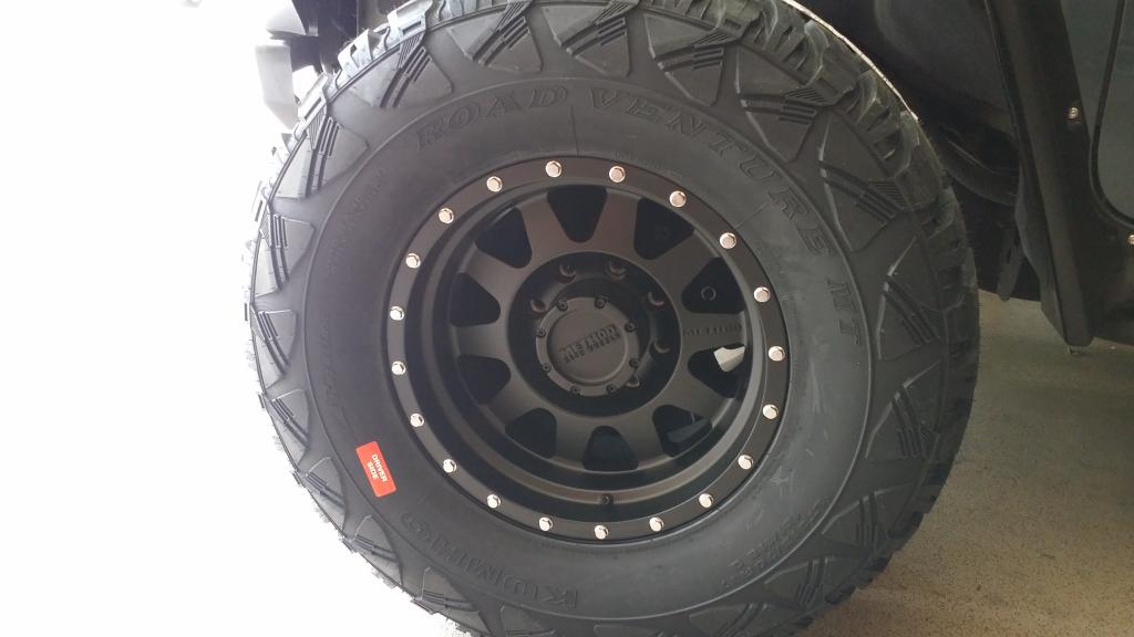

I uploaded the pics for you.
What size tires are those? 35x12.5r17s?
Your thread said that they measured out to 37, despite being 35s. (At least a 2" gain). This is a nice setup. I'm wondering myself if I should get some fenders like this & go wider (325/60r20 or 37x13.5r17/20).
