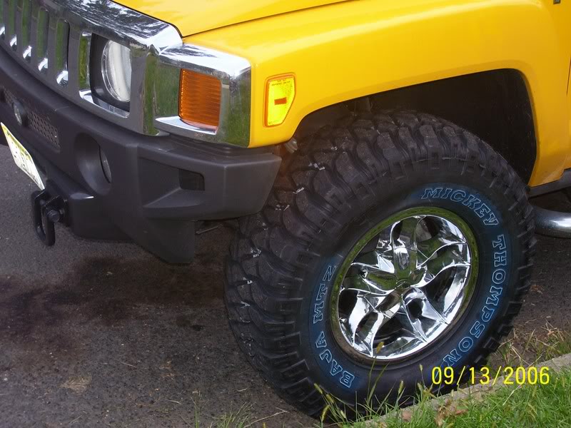

I don't have the stock Chrome wheels, I have 17" Detata rims. I'll post a better pic of the rims here.
If I had it to do all over again I would probably probably get the same thing I have now. Or I might go with a bigger tire....with some minor cutting I know I can clear a 36.
If you want your stocker rim to stick out more just go with a spacer I had to put them on myTahoe due to rubbing issues and they worked great for over 50,000 miles without any signs of failure.
here are my rims

Wash the blue crap of those Mickey's ... sheeeeeeeeeesh
