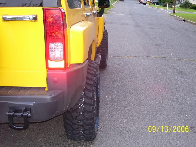

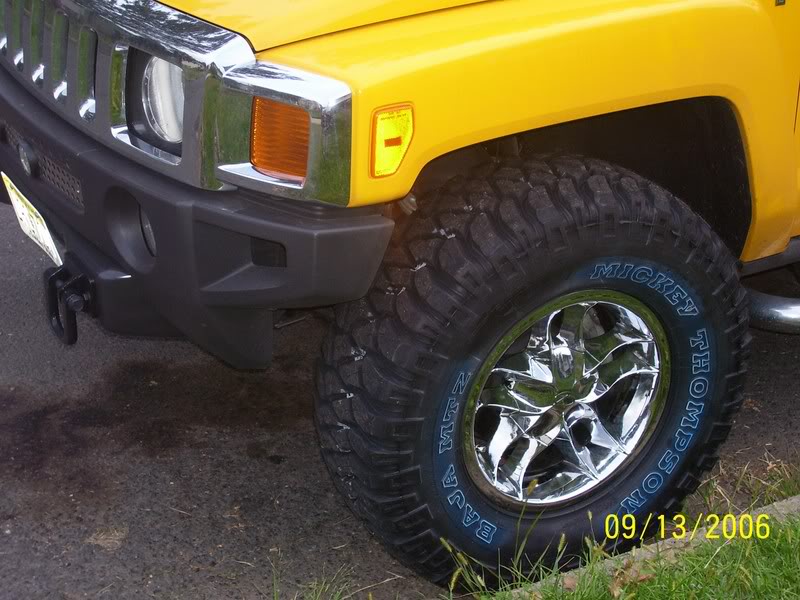

ok, I called my friend that owns a rim place, he said stock is -18 offset but that most aftermarkets are zero and +10 offset. At least in the 17-18" size, I forgot to ask him about 20's but more positive offset will only make the tires stick out of the wheel wells a little bit and not damage anything. My H3 has -38 stock and I went with +12 rims and they fit fine and look much more aggresive sticking out a little..IMO. heres a pic of how much a change from -38 to +12 looks

ORIGINAL: importkiller
Also your stock tires are 315/70/17 I think. They equal 34.4x 12.4
the ones you are interested in are 325/60/20 they equal 35.4x12.8 so you may see a small ride height increase but not much at all.
hope this helps!
Damn, those MickeyT's look AWESOME[sm=hail.gif][sm=hail.gif]
