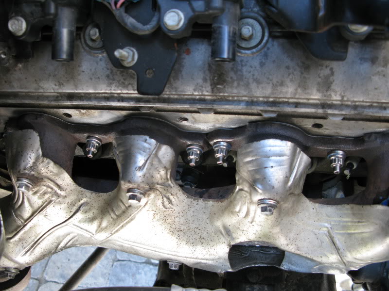

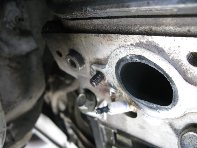

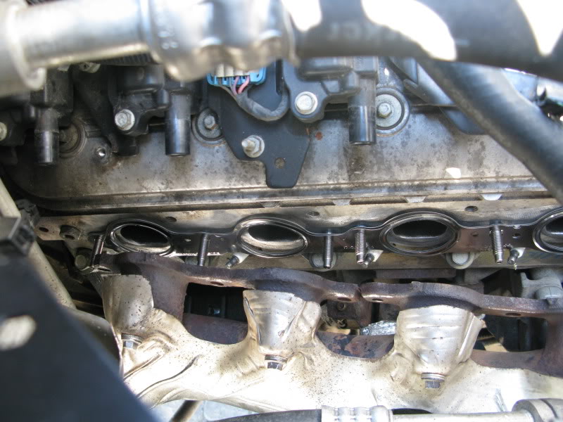

I did the install myself, here's some of the pics.

^ thanks for the pics. I've decided to go that route. Going to order them Monday. Hope I get that lucky and can turn the broken bolts with vice grips. Probably going to do plugs,wires and coil packs at the same time.
