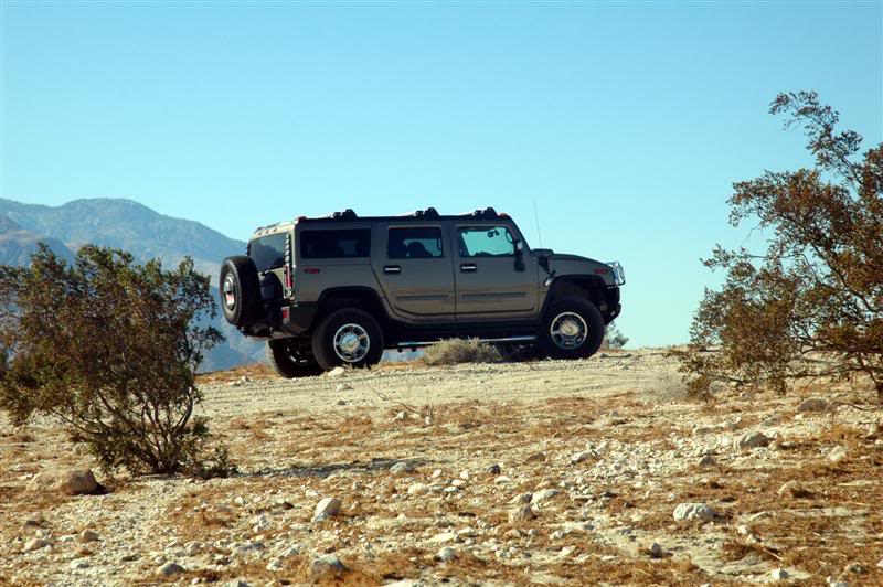

I have an '06 (UltraLUX - fully-optioned and then some)and aside from the H2's inherent windshield side pillar trim rattle which was 'fixed' under warranty,the H2'ssunroof/moonroof quit fully closing within the first two months of ownership. After the entire sunroof/moonroof unit was replaced under warranty, I've experienced no other problems with the H2whatsoever.I utilize the folding mirrors feature all of the time whilst parking, as to avoid possible accidental damage by others, and its function is operated exactly as how 'Shorty' stated. BTW, I opted for the GM extended warranty as well, after reviewing this forum for suggestions prior to actuallypurchasing my H2. Unless you really want/need to purchase an H2'right away', then I'd just might wait until the '08 models become available. Depending upon the public's interest in/acceptance ofthe 'revamped' version of the H2, there might just be a huge amount of pre-owned H2s available in a few moths at some really good deals...good luck.Name:  Winkingsmileyanimated.gif
