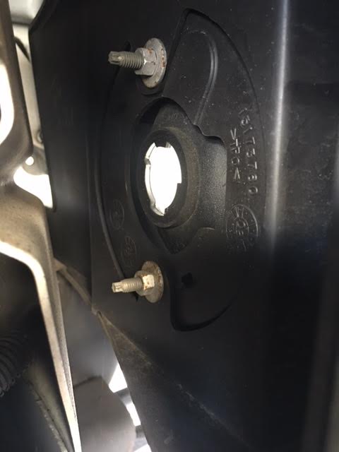

Was wondering what kind of lamp to use for the DRL's. I've looked it up and the mini bulb that everyone is talking about will not work on this harness. Am I missing something on the harness or is it another lamp I need?

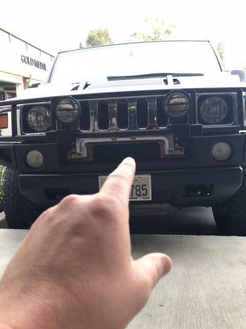

Also, I've been searching Ebay for weeks now and can not find this piece that's missing from the front. Anyone know of where I can buy one or what it's even called?

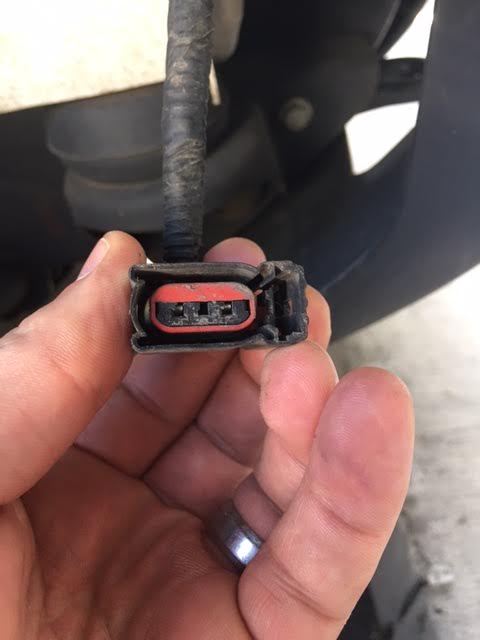

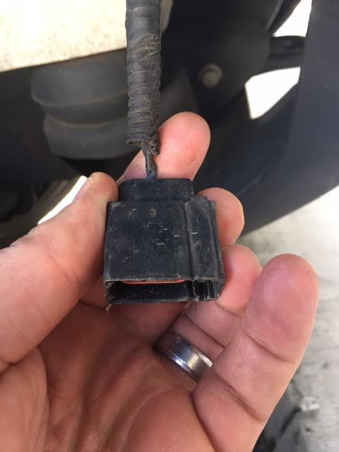

Sorry, forgot to add the picture of the plug/harness for the DRL's....

front piece is the mini grill. OEM is plastic but you can purchase after market chrome or black steel.

Thanks for the reply! What about the black plastic trim that goes around the mini grill? I can't seem to find that piece anywhere...
That is the mini grill. I had purchased one on ebay about 6 months ago. You have to keep looking on ebay or go to a junk yard. check out this auction: http://www.ebay.com/itm/2006-2010-Hu...9SdCDl&vxp=mtr
not oem but just to get an idea.

You are missing the bulb harness for the DRL's. The factory has a pigtail that accepts a standard 3157 push in type bulb.
Tim

Btw remember the Drl only works at day they do not turn on at night unless you do the drl mod
50%of new hummer owners including me, freak out when the lights doesn't work at night
