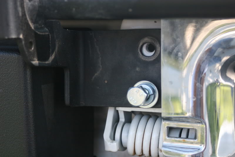

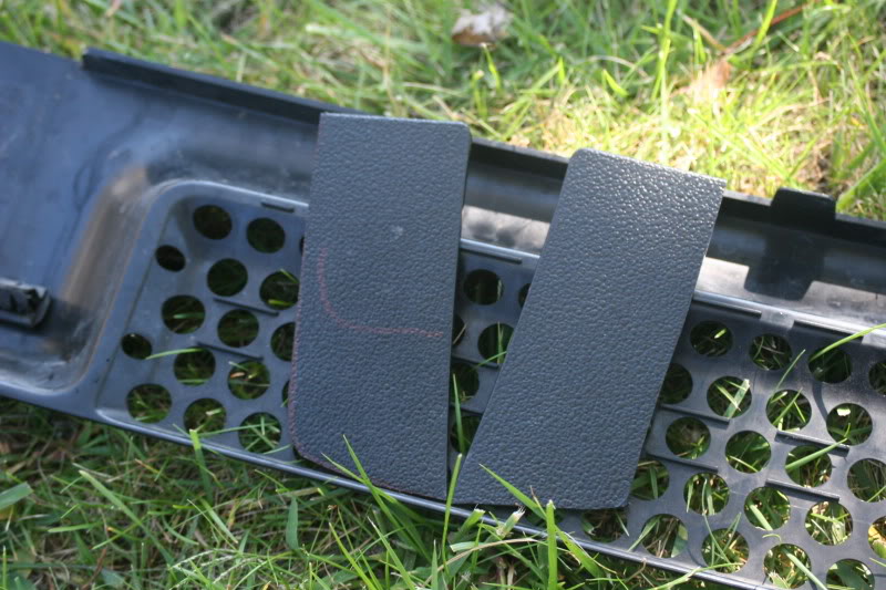

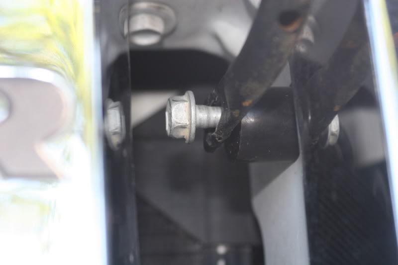

If your Hummer never had a grill on it.... you most likely will have to trim the mini grille...
