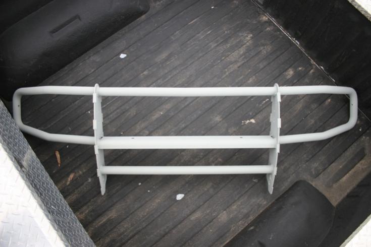

Came across two Westin Sportsman one piece brush guards on CL. Leftovers forgotten and set aside in a guy's warehouse. I bought both of them. One slightly used, the other like new with the cellulous wrapping still on it. Of course, the seller could not find the mounting brackets or hardware. Made a set of stout brackets out of 1/4" plate to snug in behind my tow hooks. Work in progress - thought I would share the first phase. I am also working on a set of mounting brackets for the other guard.

Dry fit the mounting brackets in their rough state, appears they will work - eventually each will get dressed in black. Plan to put the used guard on my H3 after giving it a new paint job or powder coat.

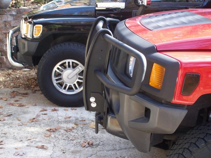

Final phase. Illumination. Done.
As soon as the other two mounting brackets are done, I plan on selling the other brush guard (with headlight guards). May post it in the HUMMER FORUMS "PRIVATE For Sale" section.
Couple of shots of our H3s - her black & chrome and my red & black.
