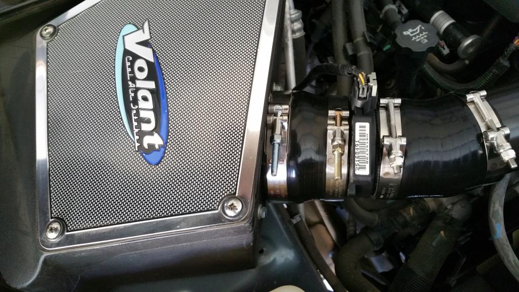

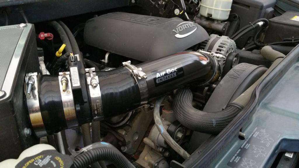

I have a build thread on the other forums, I recently added an AirDoc to my Volant box on my 06. The box does push the MAF closer to the engine so you have to cut off 2" from the box side on the AirDoc tube and I took off another 1" on the engine side of the tube. It will work but the tube has to be modified.

Here's a couple pics of the install. Look the same as any other but as I mentioned, the tube has to be shortened on both sides.

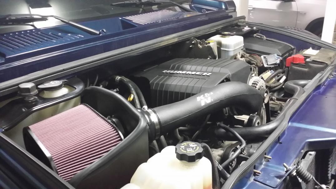

LoJac, I Finally got my k&n put on & was wondering what is the difference in it & the Air Doc & how much is the Doc? Thanks!

Tube wise, you'd have to compare the two with the specs. The Volant box and yours is probably the biggest difference. If yours doesn't seal to the hood then you're sucking in hot engine compartment air where the Volant box is bringing air in from the fender vent like stock.

Doc, i guess they're all just a personal preference but you are the Only person that i've seen that has one of these, i did see one on Amazon & they were a good bit cheaper & Nobody could tell me IF they add any Extra HP or Torque! Where as the K&N (the one i bought) adds an Extra 11HP & 9lbs. of Torque (i'm guessing that's why they're more expensive) & the guy i talked with said they sell 3 times as many k&N's as they do of the Volants (i couldn't find Any Reviews on the Volant) I also noticed on yours you had 5 clamps on it & on the other one i saw it only had 2, did you do something different to yours?
