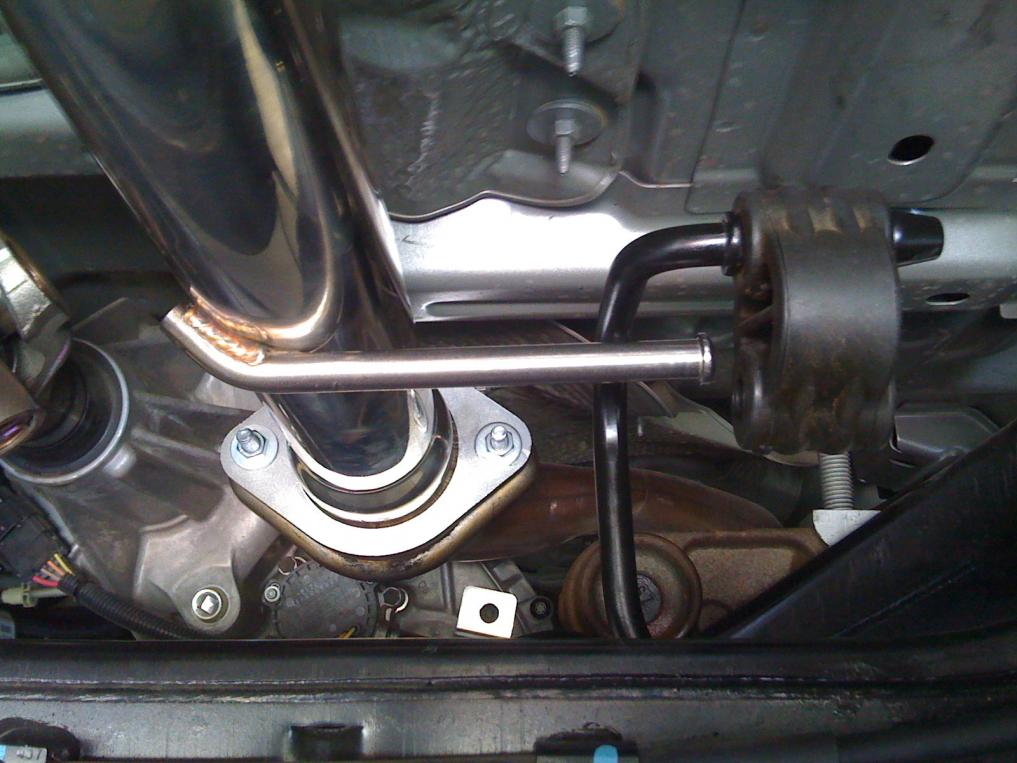

Just bought and installed a Cat back Volant SS Exhaust... I am having a few issues that have left me stumped. I think the main issue is that when I bought it they said it was for 05-08 Hummer h3 3.7L trucks. When I look up the part number Volant Exhaust #15635750 its comes up everywhere as 05-07? I am not sure if there is a difference in 08?
(See photos)
Issues:
1. Look in photo you can see where the exhaust pipe attaches to the cat pipe the Hanger there does not reach the rubber hanger on the chassy? Any ideas? possible fix?

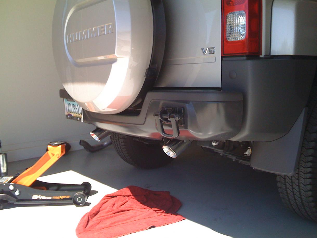

2. Exhaust tips seem to hang to low and one side is slighty higher than the other. There does not seem to be any adjustments to make since the muffler just hangs on the hangers?

Also I am trying to raise the pipes about 1/2 inch to 1 inch higher to be closer to the cutouts.

I actually decided to keep the system since i got a good deal on it. 250.00 installed.
I went to the exhaust shop that works for the dealer and they said the 07 and 08 system is the same except that hanger problem. They ended up fixing that by welding an extension on the hanger so now it reaches the rubber hanger...
The only thing about the Volant system i dont like is the way the tips come out on an angle as opposed to straight out like the others.

Volants do point their tips downward more than the above MFGers, and they use high chromium content so they are nice and shiny, which is useless up north as the first winter will have them looking like everbody else's CAT back systems.

Yeah... No the guys seems like hes legit. He's installed over 100 of these systems. The hanger position of one the hangers near the head in the picture above is the one that was short. He said he had to weld extensions on almost every system he has put in. He did an awesome job on it BTW. Highly recommend him in the PHX area.

Anyway its installed now and looks and sounds great. Im going to see if I can have the same shop change the way the tips go down. I like them straight! AHHH im too ****.
