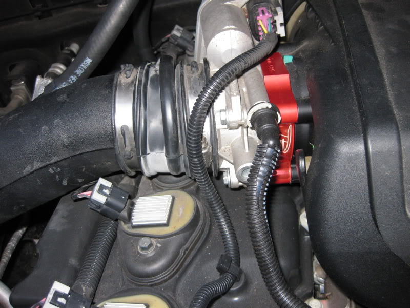

I just installed mine, got a sick deal on it with the Airaid TB spacer for free so I threw that on aswell. Problem was the Volant CAI was missing the Hump I believe and the I had to use a stock piece to get the intake to the TB. I didnt have any directions so I kinda just went at it blindly. Does this look like your setup? Can u post a pic of your setup so I can see if I did it right. Thanks. Also, what is with the huge opening at the bottom of the box? seems kinda big since the factory box had like 2-3 small drill holes to drain water, I am guessing. Do you reuse the little air inlet attached on the stock box into the wheel well? I didn't see any way to do this so I figured you don't thanks again.

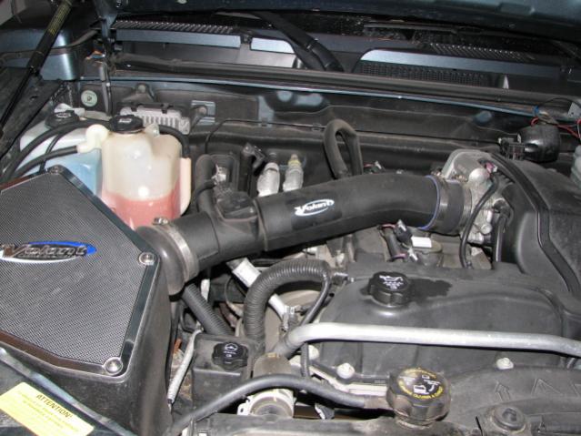

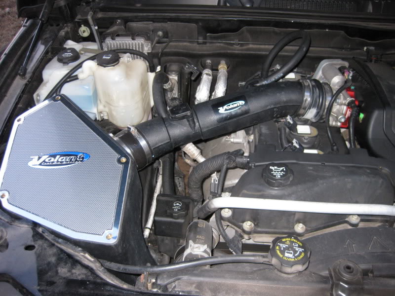

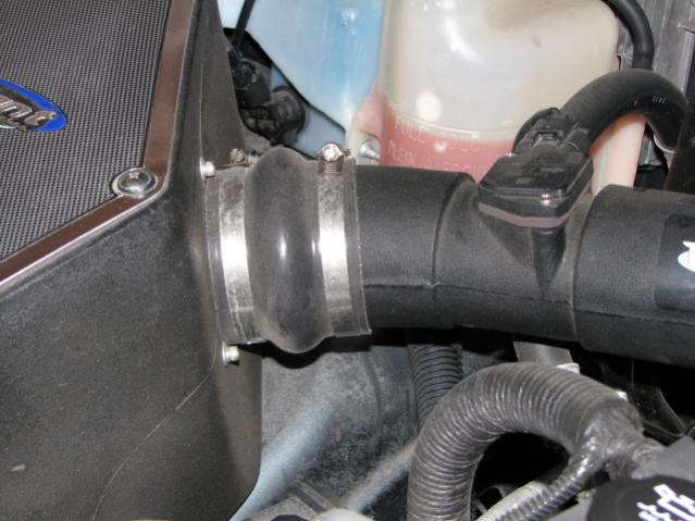

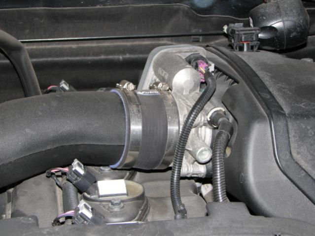

Hey JDTDBD,
Looks like mine, minus the TB. Attached pics of my install. I didn't reuse any of the factory air inlet. Let me know if I can be of any other help.
