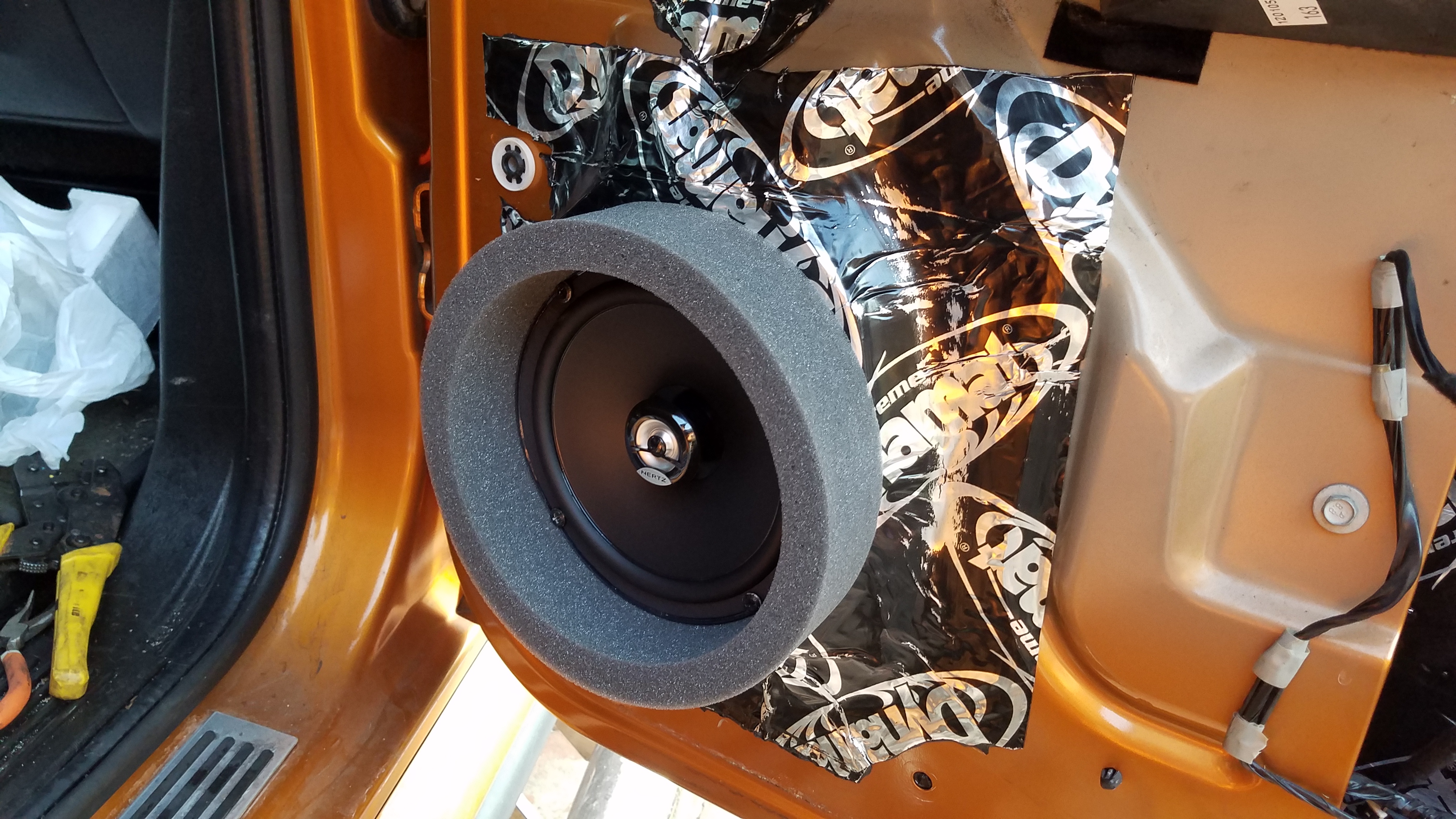

Still some changes to be made but sound improvement was noticeable

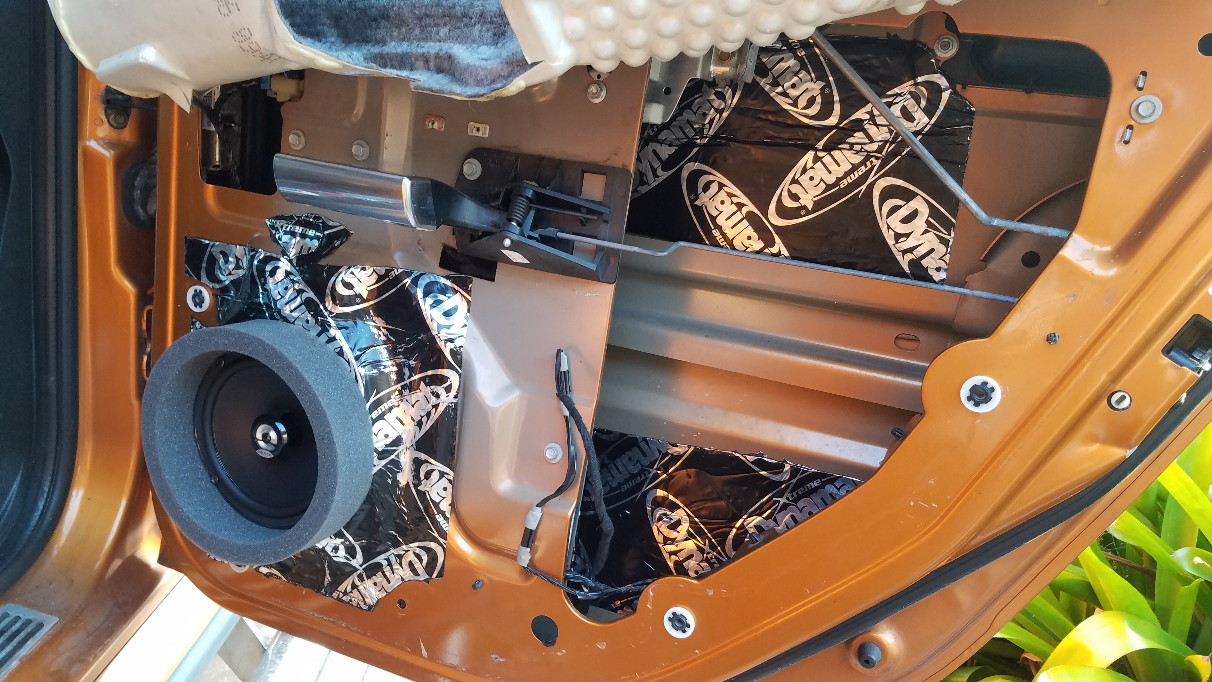

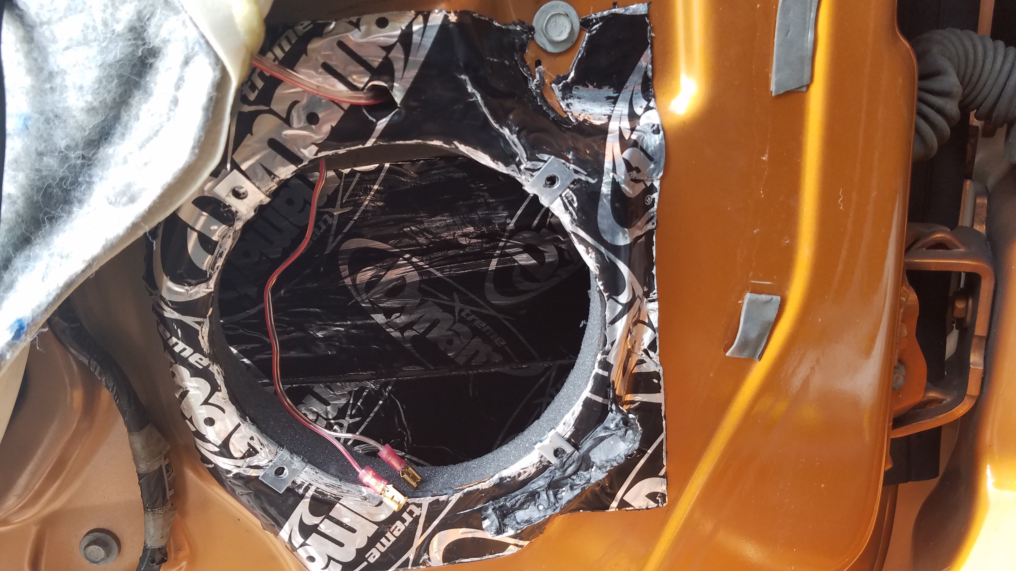

The dynamat made a huge difference however only on the rattle and vibrations from speaker .
I didn't insulate all the door , neither seal the hole for the window regulator so I can't comment on noise reduction
The fast rings are a great deal and an easy way to improve mid bass
Thanks Baldfox for all the advises
Overall I'm happy with the Hertz DSKfront , Dcx rear great sound and bass but will look to replace the tweeters. They are a little harassing

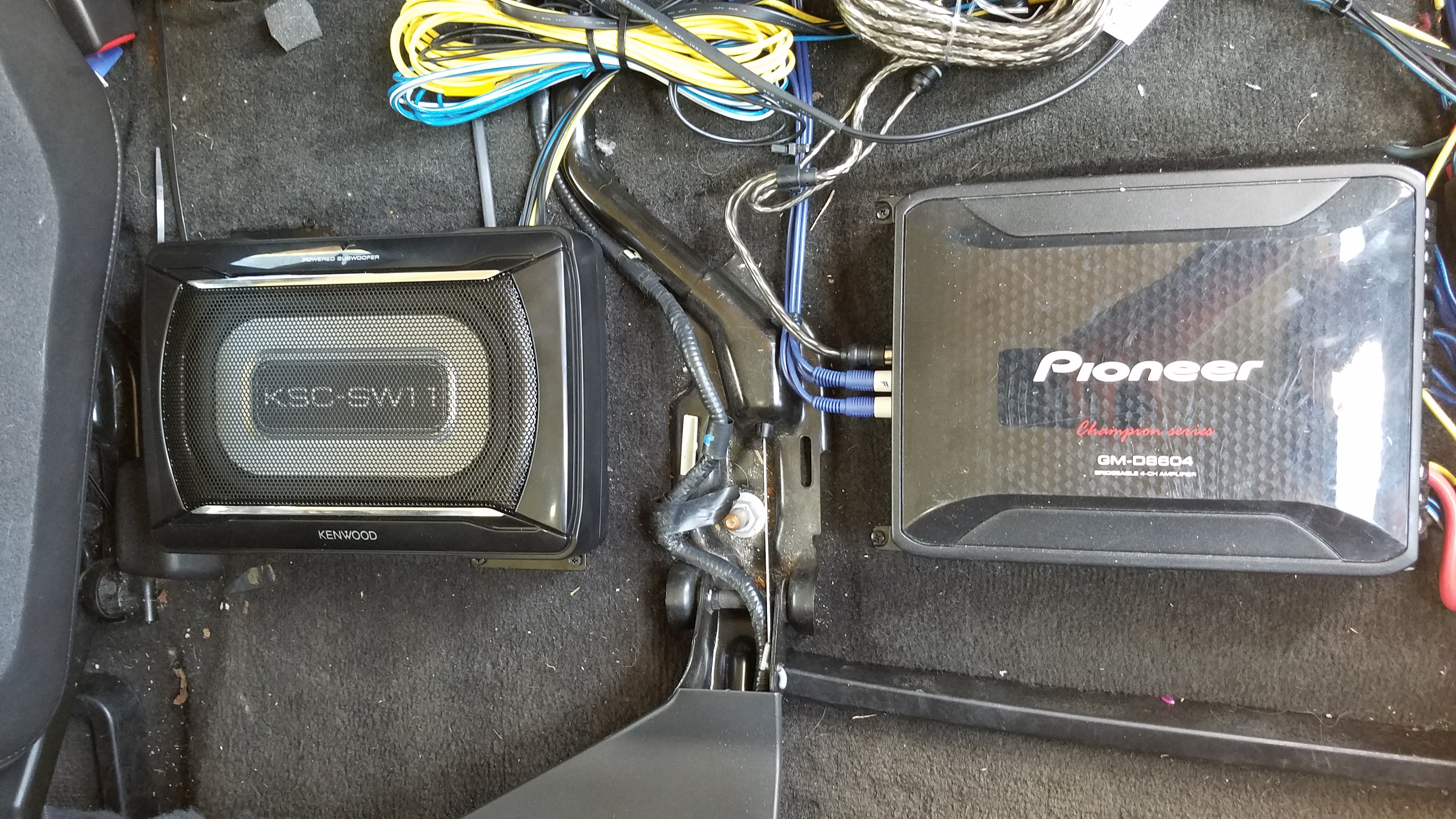

The kenwood powered amp does help to get some bass kick but do not expect a deep bass . Still good enough for me and space saver is a plus . Was easy to install . As it only consume 7amp I connected to the amp power supply ,ground and remote ... my Amp has a output rca so didn't have to run new cable from the headunit

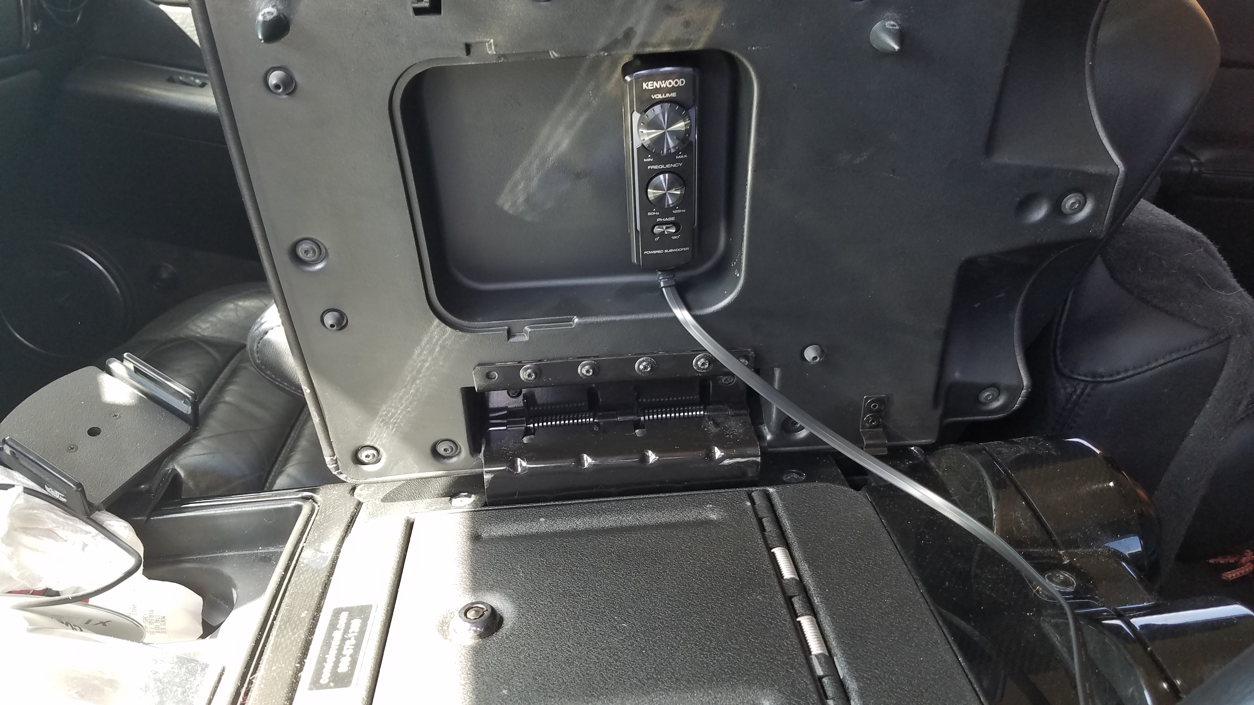

Hide the control on the center console. I don't like stuff hanging around
Now I'm waiting for the onstar box replacement so once I remove the console will replace and relocate the Rca

H2Miami
How did the sub under the seat work out? Everything looks clean. I like the remote under the console. One thing I miss on the H2 is storage.

The is much better than expected (my expectations were low)
Or give me the bass I was looking. . Not too harass. Is not a really deep bass but when played loud you feel the vibration in your body
It fit perfect under the seat taking not space at all . Even the seat fold all the way down

whats am i looking at with picture #2?
I know i see styro foam around the speaker in picture #1, but in pic #2 it looks like the styro foam in the door and had dyno mat over it??

The fast rings come in 3 pieces . One for the door . Behind the speaker
One for the door interior (what you see in pic 2 ) it os supposed to be stick on the speaker but attach it to the door interior was much easy
And one for the speaker front . To seal tye gap between speaker and grill
I cover the speaker hole with the dynamat to avoid vibration which was very bad before
If you start with the front doors and think the doors are flimsy wait till you get to the back door ( that sound wrong) better let said rear doors
I spent much more dynamat on rear and still.got short for another package

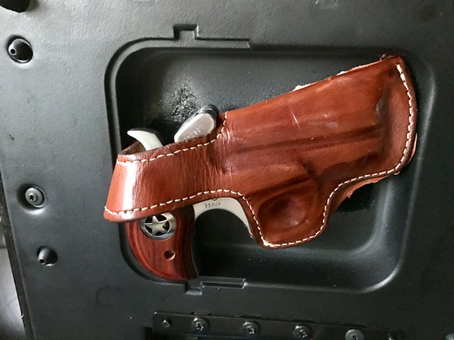

Lack of storage space has always been a problem for me. The way you mounted your subwoofer control gave me this idea.
That is nice ... I got to find a way to put mine . I got a safebox in the center console but only to hide the gun when I'm not carrying..
