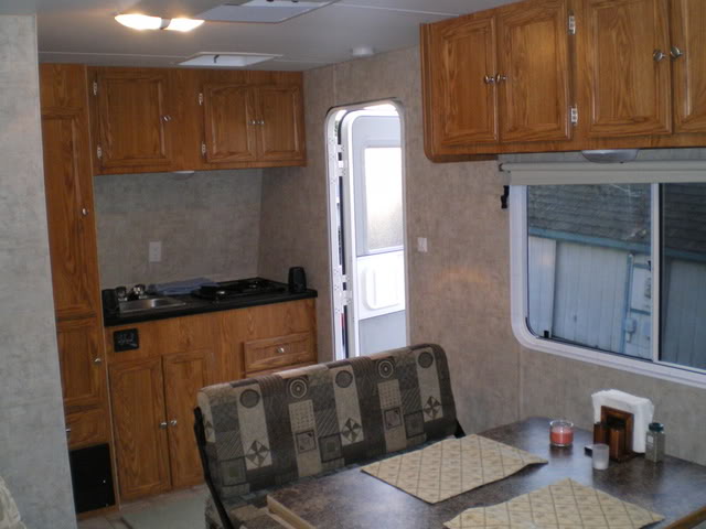

Default RE: Travel Trailer, Camper, Towing H3 Alpha
Sounds like you have a nice looking H3
My trailer is a 200815' American Freedom. www.freedomtoyhaulers.com My model isnt on their website.
Its a good entry level trailer, hasall the amenities you need for a decent price.
