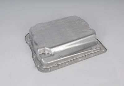

Nope. H3s have an H3 pan (also 4x4 Colby/Canyon) with a cut out for the right side front output shaft from the T case.
