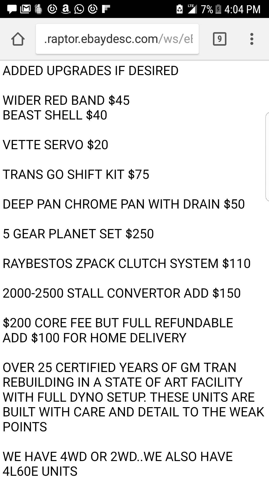

I git a quote from them . seems to be a great option as tgey offer 3 years nationwaide compared to the 1 year local
did you get any upgrades to heavy duty with them
I just emailed to cbeck what can be upgraded..

I got this answer about the upgrades from street smart
► Oversize PR valves utilized to restore hydraulic integrity
► TCC control valve, TCC regulator valve, and Actuator Feed Valve updated to address common wear problems.
► 1-2 Accumulator Pistons, upgraded to aluminum, replace the OE plastic pistons that can cause premature clutch failure.
► Tru-Flat stator qualification and machining process.
► Sun Shells updated to the latest, stronger, and more durable design, eliminating common OE failures.
► High Energy 2-4 band installed to increase durability over the OE design.
► High Energy 3-4 clutch pack, upgraded from 6 to 7 clutches to increase durability and torque capacity.
► Remanufactured pump, with new line bore bushings to eliminate leaks and provide superior flow and durability.
► Remanufactured valve body, with complete system correction and recalibration kit, improves pressure control and shift quality.
► Remanufactured and improved torque converter tested for leaks, concentricity, and balance. Upgrades exceed OE requirements and eliminate the possibilities of front seal leaks, premature bushing wear, and vibration.
► All new, bushings installed in key locations to improve internal fluid flow control and fluid pressures.
► Complete system correction and recalibration kit installed to address several OE flaws. Modifications include updates to servos, the PR system, and valve body accumulators.
► Heavy-duty recalibration kit installed to reduce slippage and increase durability.
► Complete road simulation using a dynamometer testing program called C.A.R.S. (Computer Aided Road Simulation). Every transmission is cold and hot tested before shipment.
