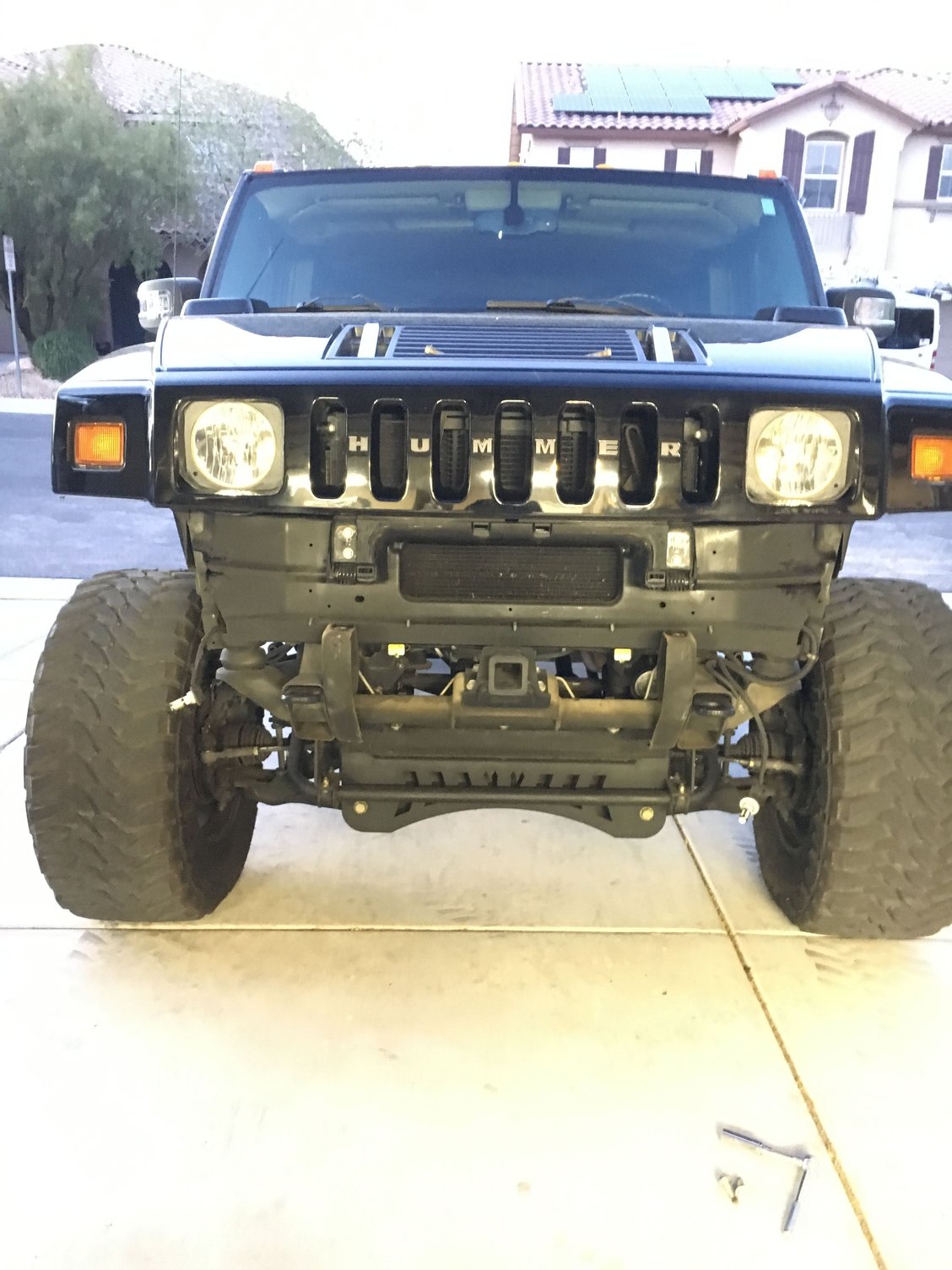

So my cooler has shipped and I will be removing my radiator and sending it to Be Cool so they can copy it and it will have oil and transmission cooler in it. I have all the bumpers and trim at paint shop and while I was removing everything I discovered it had a leaking input shaft on the steering box so I removed it and had it rebuilt and reinstalled it. It’s been a really bad week for my H2! I was going to have gears changed but it will have to wait a few weeks because it will be down as long as it takes be cool to make it and ship it... they make a radiator for a 2004 but I guess the 07 has a 34” core and maybe mounting locations might be different.
Old Apr 24, 2019 | 03:21 PM
maxjeep's Avatar
Joined: Mar 2019
Posts: 319
From: Las Vegas
I pulled the radiator out this morning and it wasn’t too bad. I was able to tilt it back and remove it without removing the top of the core support, I was reading that OP had to to get it out and I might when I put the new larger one back in. I will box it up and ship it to Be Cool so they can copy it. I was amazed at how small the core was. I should have bumpers and all my plastics done on Thursday. I will have plenty to do while waiting for my radiator to be fabed.
