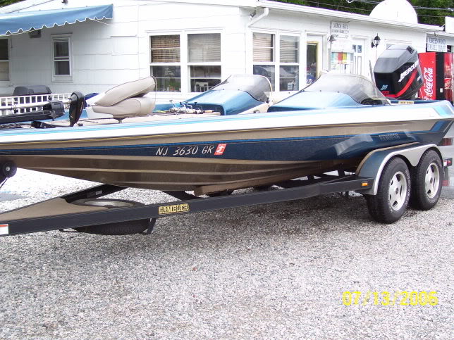

tr21 is a triton, correct? I tow my 22' Gambler dual console with a worked 250 with no problems at all.
