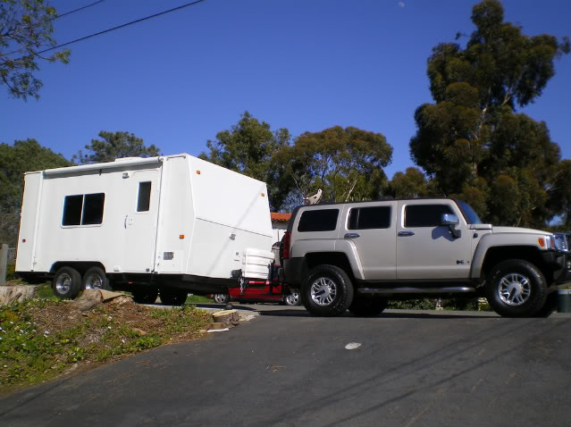

I have been meaning to post this pic. The trailer has an unloaded weight of 3000 lbs. I had 60 gallons of water, about 500 lbs worth of H2O, a huge pile of firewood, and all our camping stuff..I estimate the trailer was around 4000 lbs. keep in mind the H3's towing capacity is only 4500 lbs.. I use a weight distributing hitch, notice how the rear end is not even saggin, it still looks level with the front. At close to max weight no sag, not bad huh? I was impressed.

Well.......how did it hold out on the tow??

Oh, BTW nice trailer.

ORIGINAL: SteveO
It towed better than I expected. On the flats I was able to cruz at 55-60 no problem ( which is the speed limit for towing trailers in CA ). On some of the steepest grades on the freeway I slowed down to 45-50 but it still wasnt all that bad.
It never seemed to bog down or really struggle. It's no V-8 but for a 3.5L it held it's own
In a nut shell it did good [sm=icon_cheers.gif]

Sounds like you have done ALL of your trailering homework. Good Job! Weight distributing hitch is #1 IMO and really does wonders for the whole trailering experience.
But...I do have questions;
[ol][*]Manual or Automatic?[*]Electric trailer brakes?[*]If Auto, tranny cooler?[*]If Auto, did you have to tow in Drive3?[*]Mileage with loaded trailer?[/ol]

ORIGINAL: RealJeep
1. Auto
2. Yes, I installed the brake controller, piece of cake
3. No. It would be nice to have though...I watched the engine temp and it stayed normal.
4. Yes, stayed in 3 the whole time except when going down some hills
5. Not sure yet, probably dont want to know

Nice trailer/toy box....I'm curious what does one of them go for?
