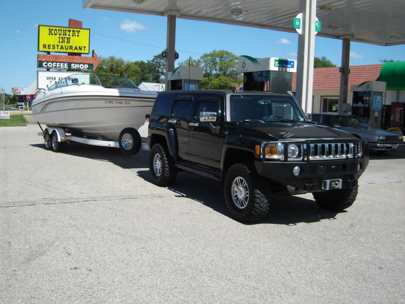

It is the wheelbase between the Alpha and the Envoy that changes the rating, not the muscle.
I hauled this Big Block 2330 Chap back to SE MI from just south of Milwaukee,WI with my 07 65MPH up big hills and 75MPH down the other sides. No worries.

Thanks for the replies folks. I know there's no clear cut answer really other than stick with the recommended and I believe I'm close. Fortunately I don't tow it often (2x a year to bring home and clean up) and not far so perhaps I just give it a slow go, be cautious and see how it compares and contrasts to the Envoy. Time for a drop or adjustable receiver now, the Class IV I had from Lowes was horizontal and had 3 ***** but I think it'll sit too hit and create too much tongue weight.
I must have had it good with the Envoy comparably speaking to other SUVs in the 6cyl range as it was within rating but I'll tell you it looked and felt like a match box car pulling a yacht or cigarette boat and felt like it to boot!
Doc your picture is worth a thousand words I'm probably close to your 23' there, thanks. Am I safe to assume dual axle Shorelandr for 22-24' boat at approx 1500lbs??
