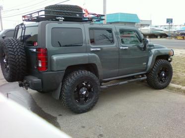

Default My truck might help you
second pic is factory rake with stock rims and General Grabber 315/75/16
first pic 18x9 Rock Stars with Nitto trail 35/12.5/18 with front leveled
You can always lift it higher later on, I also got rid of the nerf bars and put on rock sliders. I use both sets on my truck depending on what type of driving I do, if I go hunting in the mud and crap I use stock, if it is just sand or the beach I use the Rock stars.
Attached Thumbnails Totally Confused About Lifting and larger wheels/Tires !!!!-untitled.jpg
Old Dec 28, 2012 | 01:52 PM
nijoma's Avatar
Joined: Jan 2011
Posts: 320
Default Just a note
If you go with the rock stars the center cap sticks out, not sure why but looks like crap. Get shorted bolts at your local Auto parts store, stainless so they do not rust. Cut the back of the center cap down, very simple its just plastic and set the centercaps flush. Look closely at my truck the center caps are out and away from the rim. Very simple to recess them and looks so much better. My truck leveled with the 35's and the roof rack clear my garage by an inch or 2 so I cannot lift my truck any higher. Plus the rock sliders are not really a step so my wife and kids would not be able to easilly get in if I lifted it. I do not like the look of the steps that come with the rock sliders.
