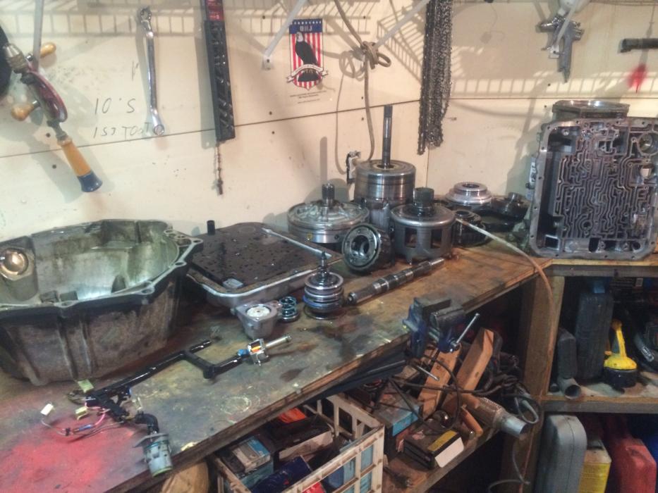

Hey guys I'm in the middle of my tranny rebuild and I need some information quick. I Don't know whether or not to change out my Torque converter. If I do what RPM stall should I put on it. It's stock right now at 175k with 37" tires. I plan on putting a small lift and maybe some small engine mods with the next few months. (Later on a supercharger, but not for a few years.) any information could help. It's my first rebuild thanks guys.

:d halfway point!!!

- About 4 hours for me to remove the drive shafts, driver side exhaust, transfer case, starter, and the tranny (It should have been faster but I had a bad exhaust screw )
- About 2 hours for the breakdown.
- Another 3 hours for the assembly so far (only about 2/3 I had to stop because they forgot to send me a friction plate)
I had to stop because I realized I had a bad reverse input drum. So I have to wait till the extra parts come in to finish it.
