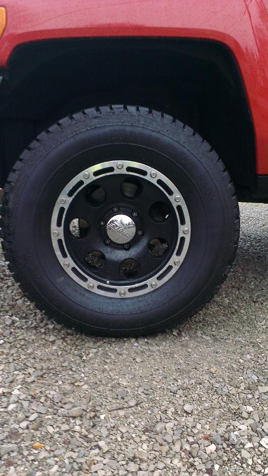

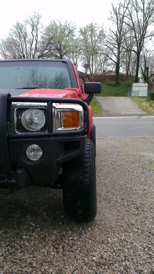

So I just got my H3 and it has eagle alloy 185 rims... But the spare is still the stock chrome with a cover over it. That drives me insane. I wanna get another rim to match the 4 on it... It's a 17" rim but I don't know anything else about it. Width... Offset. Stuff like that. The tires do stick out further than the fenders... Not a rediculous amount but further than stock... Is there a stamp somewhere I should look for? Where can I get the specs? I wanna make sure to get a matching one for the spare.... PS.... I'll be lookin to sell the stock chrome spare if anyone's wanting one rim.

post a pic of it on here and I'll look it up.

heres what i got

looking on their website, hers what ive found...
17x9
6x5.5 pattern
-8 offset
4.625 BSM ?
it doesnt look like they offer a whole lot of size configurations... i just looked at the one that had the H3 bolt pattern. i assume the 6x5.5 is the correct pattern?

Diggles,
It think you have found the wheel that you need.
17x9 looks right
6x5.5 is correct
-8 offset (is a meaningless number. It's the result of width & backspace. It's really not important.)
4.625 = Backspace measurement (it's smaller than OEM, so that is what makes your tires stick out approx. 1" more that stock.)
It looks like that's what you have in your photo.
