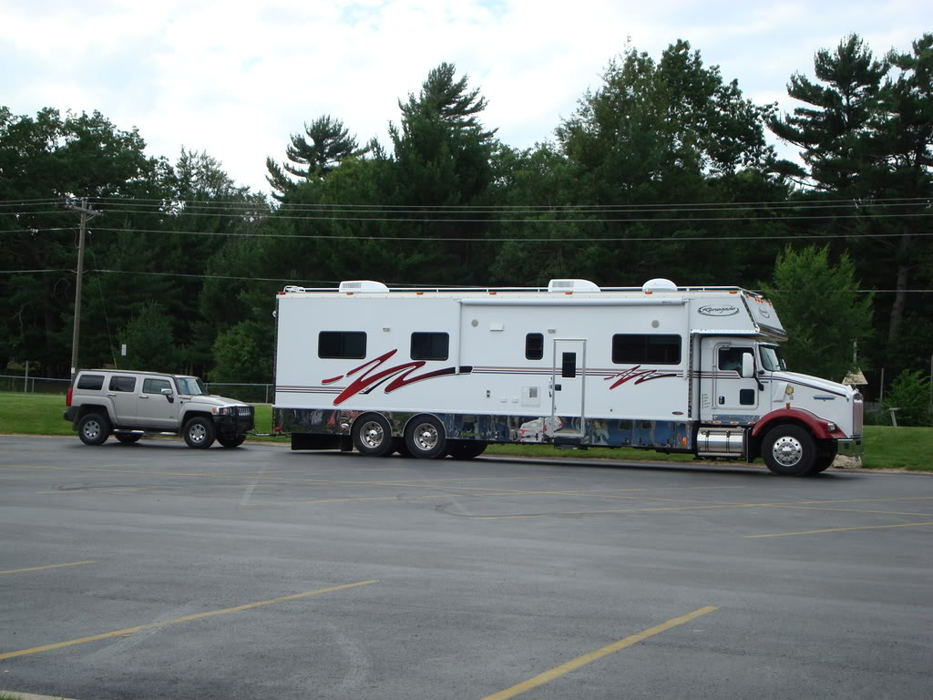

I tow my 2008 H3 Alpha behind my motor home. I put the transfer case in neutral following the directions in the owners manual*. No issues. Tow 4 wheels down. I installed the Blue Ox towing equipment onto the front of the Hummer. The original tow rings installed at the factory are not recommended for towing.
*with engine running, transmission in neutral, parking brake on, push the 4 high button and the 4 low lock button in simultaneouly and hold until Neutral light stops blinking and is solid (takes between 10 seconds and 60 seconds). Place transmission into drive for 1 second, then place transmission into reverse for 1 second. (This will let you know the transfer case is in neutral). Switch the engine off, place the transmission into park, remove the key. Release the emergency brake.
Hope this helps you with your decision.
Old Feb 15, 2013 | 07:27 AM
Posts: 13,111
Looks like this.
