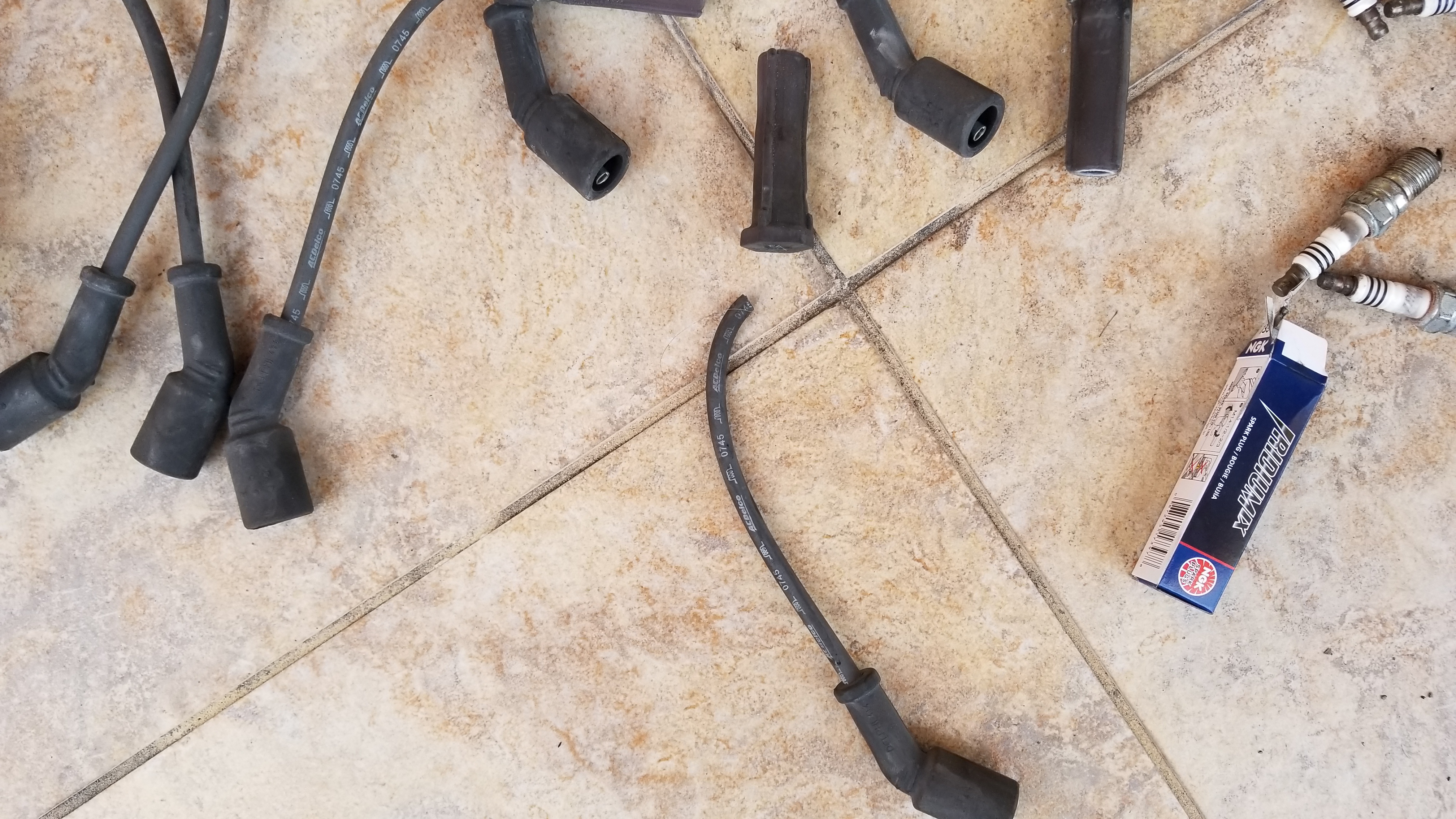

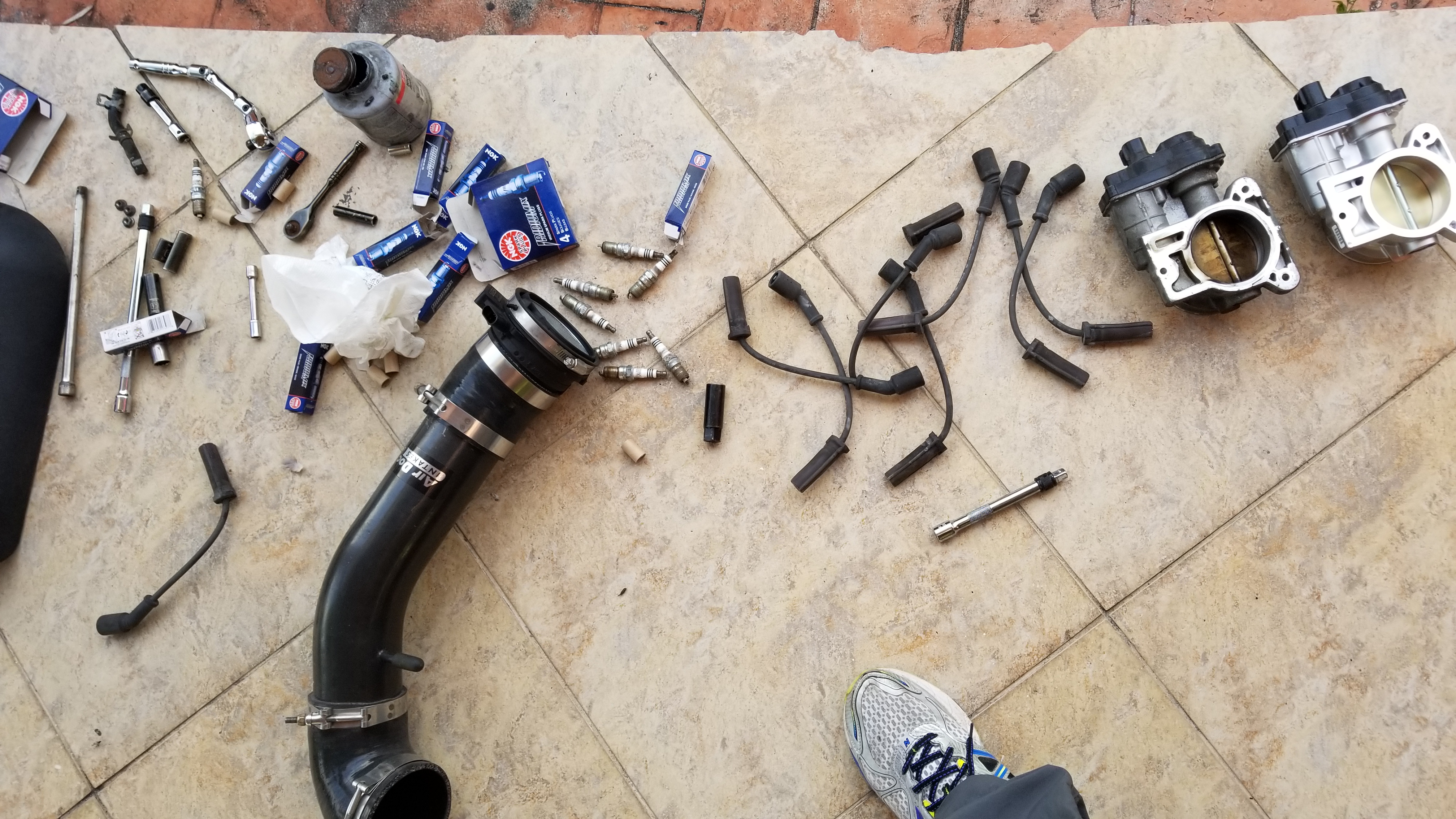

Spark plugs ..wires and Throttle body replaced
As a mantenience I replace all stated above
Found one of the wires broken with just the fine wire still attached . Guess I found the lost of Mpg and some lack of power
However the rough idle while stopping is still there . Im beating it can be the brake booster

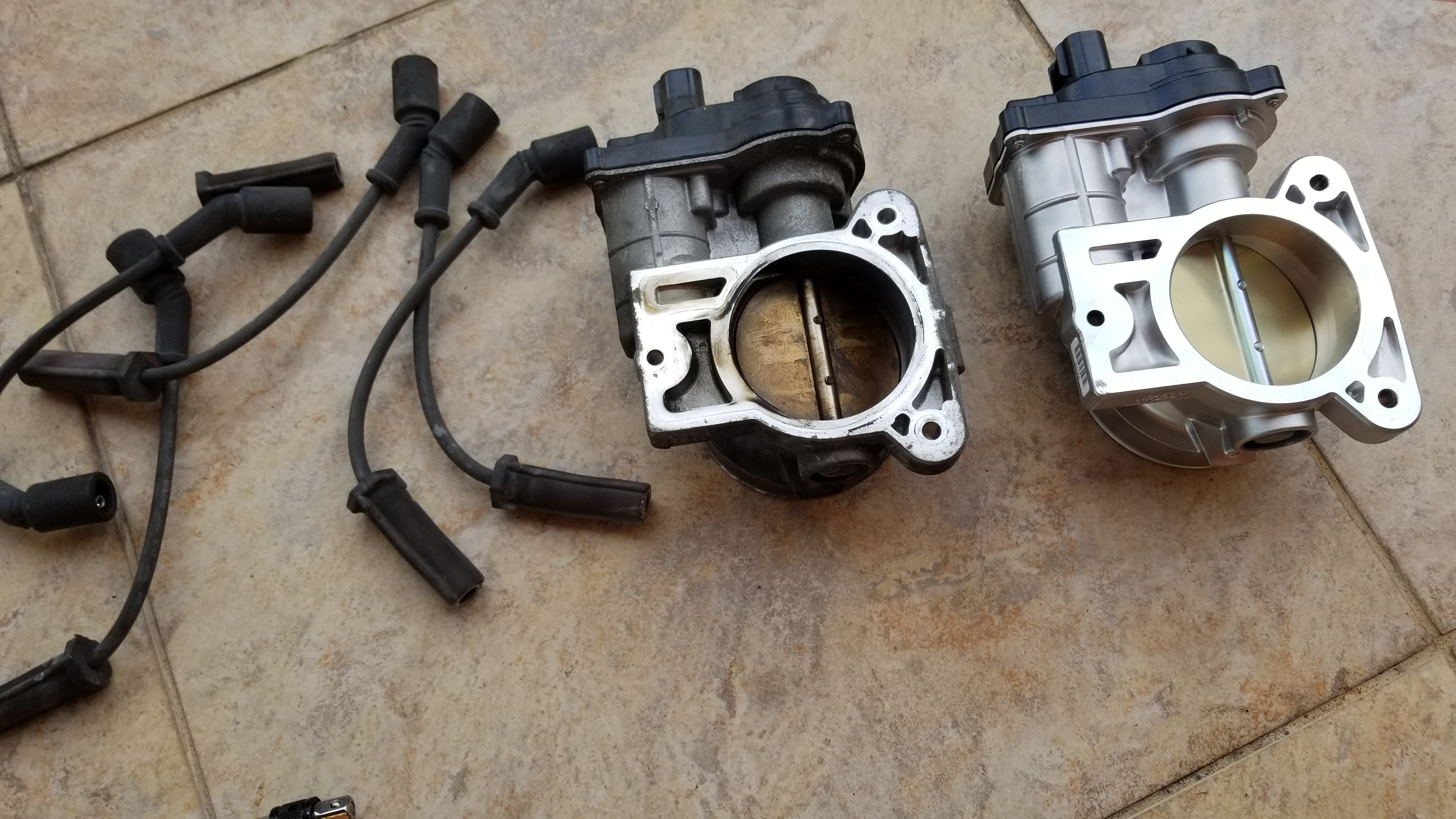

TB was replaced as a preventive after a power reduction happened few months ago which may indicated a bad position sensor

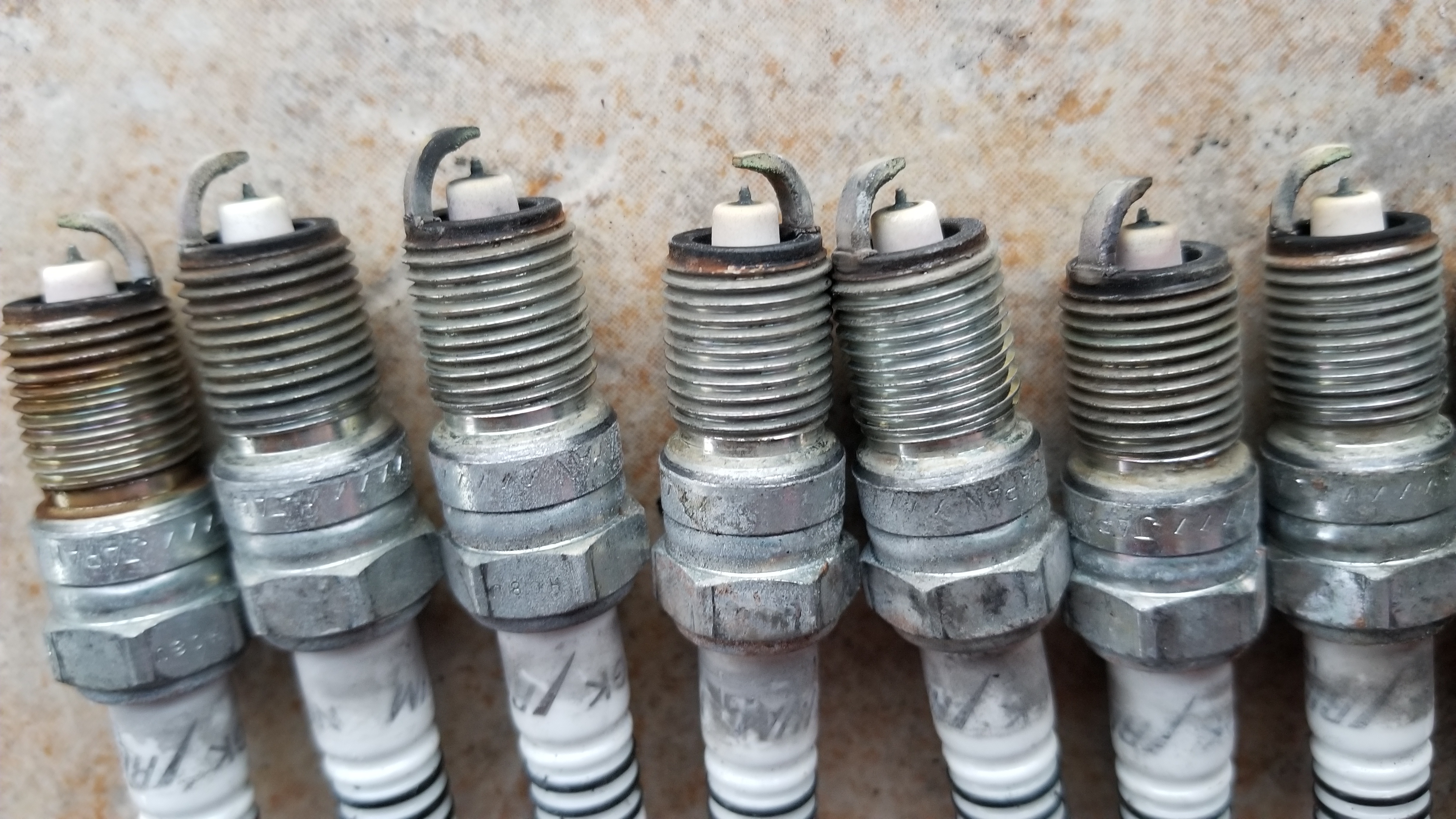

Glad to see the spark plugs were in such a good condition after 50k miles .

The Tb was any overkill . I could have cleaned the old one but a few months ago got a suddenly power reduce engine while driving on speedway . Dealer told me it was the Tb position sensor .
