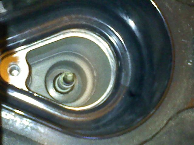

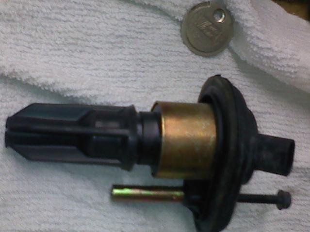

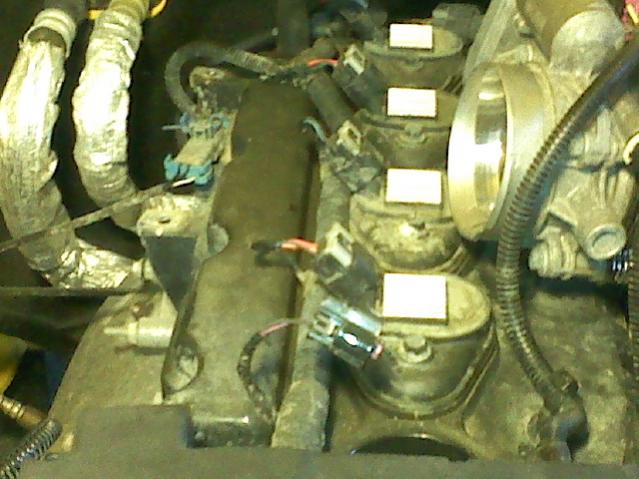

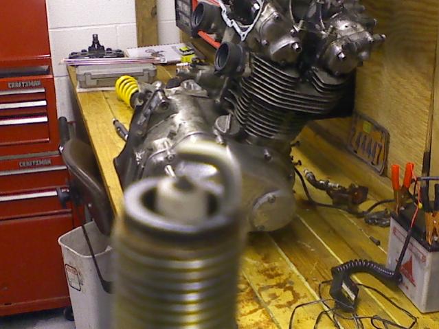

There is about 65,385 miles on my H3. After changing the spark plugs the startup seems easier, the dreaded dip in RPM's has gone away. I definitely urge you to get it done. The gap for all the plug was at .044 mm. I found it interesting that the part numbers were different although the plugs were both ACDelco. It seems the diode in the spark plug flattened out where as the new ones have a point.
