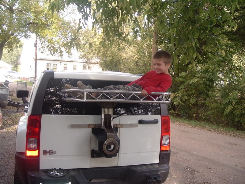

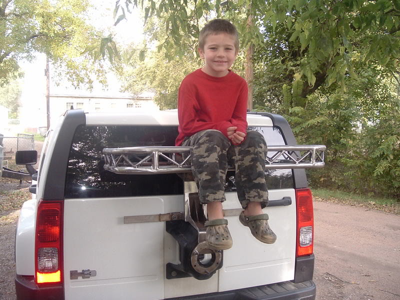

well,here it is,all but paint,i added some material to the support so i dont need any down riggers,as you can see,my boy got on it,it moved 1/8 inch,which i was fully expecting,with 150 lbs on it,it moved 1/4 inch,but it is made w/ a 3 degree andgle,so 60+lbs levels it out almost,i just need to cut off those straps on the main bracket.this came out sweet,as soon as gunner gets with me on paint,it will be done,all in all i will have about 150 total in material and suppliesName:  sparetirerack3007.jpg

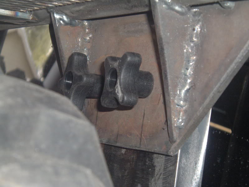

i chose to go with no down riggers due to when i tried them,they wanted to push that strap into the door,and thats just bad news,so i added material where it would benefit it the most,and it only attaches with 2 hand nuts,i made a bracket that will slide over the top of the main bracket,and then put two nuts,just to hold it,and it works great

it looks great nice fab job .............. kids sure make good guinea pigs eh!
Old Oct 21, 2007 | 10:49 AM
hilljob26's Avatar
Posts: 2,077
Default RE: spare tire rack ROUND 2
HES ALWAYS WILLIN FOR ANYTHING,ESPECIAL;LY IF IT MEANS HE HAS A CHANCE OF FALLEN ,BUT NO LUCK THIS TIME,I BET YOU COULD CARRY A SPARE ENGINE ON THIS THING
