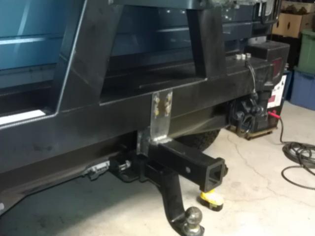

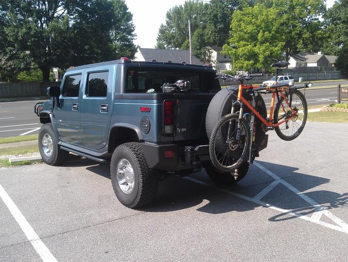

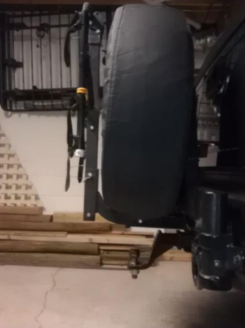

I had the same concern. So I added a second hitch on the swing away tire carrier to mine. I only use it for bikes as it is not designed for towing. But it works great, any bikes on the bike rack will swing out with the tire carrier and allow access to the bed of the truck. All it took was a little welding and a 2inch receiver tube from tractor supply for 20 bucks

No problem Det2008SUT, it works better than I thought it would. No problems with the law yet and I have had it like that with the rack on the whole time for about the last 9 months all across TN and mostly in Memphis. I figure its no worse than putting one of those racks on any other car with a hitch or pulling a trailer for that matter. Plus the cops in Memphis probably have other things to be concerned with than my bike rack if you know what I mean...
Only issue, pay attention when you close the tire carrier with bikes on it, if you aren't careful the bikes with hit you in the back if you are in the way...
But overall no real problems. The tire carrier has no problem with the weight of the bikes either. The spare is at lease 100 lbs stock so another 20-30 lbs doesn't make a big difference.
