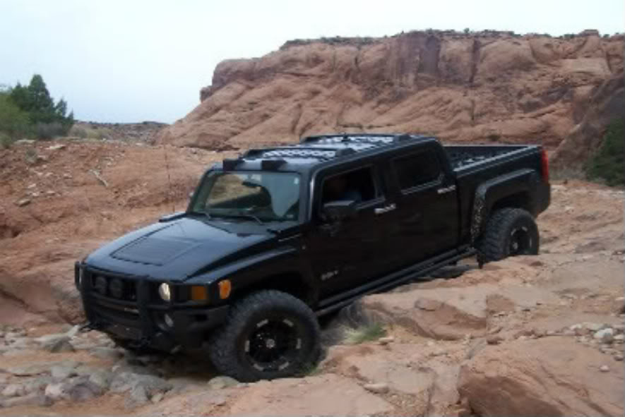

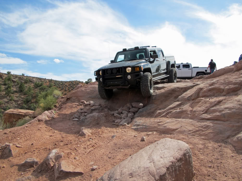

I have set #00001 of RD's H3T Rock Bashers and I can't say enough about how good a product these are & glad I have these on my T. IMO, these truly are the strongest & top-of-the-line sliders out there for the H3/H3T & the material selection and quality of construction is superior to even the OEM sliders. If you plan to wheel your H3/H3T then invest a little more in protection and you’ll save that & more at the body shop. Here's a pic of them in action in Moab.

The Terrain in Moab pretty much dictates that you need rocker protection, even more so if you have the longer wheel base of the H3T... Bigunit's purchase was obviously well thought out... He wheels there quite frequently, since it's practically his back yard...
I don't think he was trying to bash you or insinuate that you don't wheel Talus...
