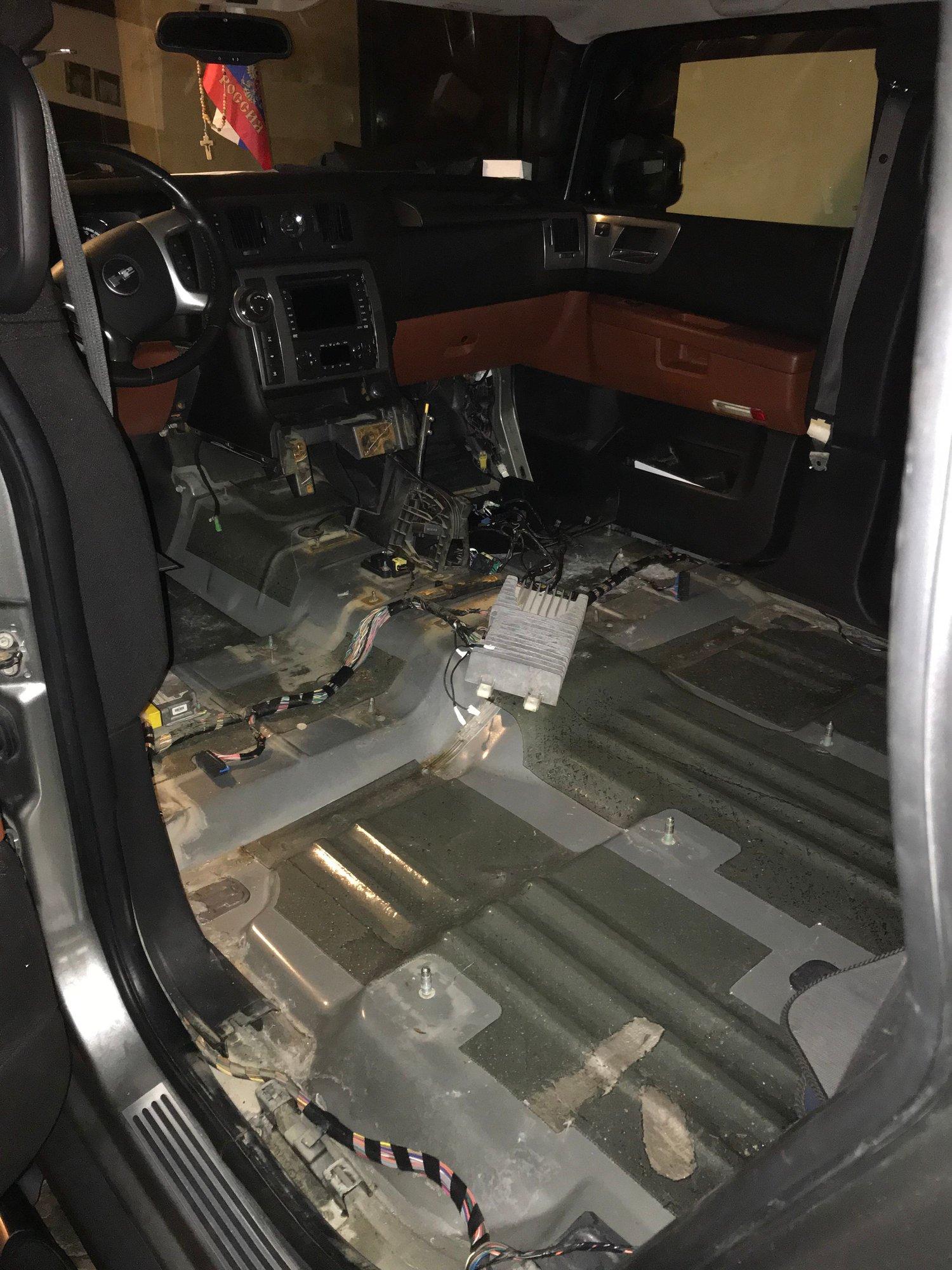

Dear All,
I don't know what to do... Please HELP & SOS
I have a bad smell in my H2... i remove the seats, the carpet, the insulation... and when I close the car for 24h, I have again a bad smell.
it is not coming from the ducts since i don't smell anything and no smell even if i turn on the AC or heater.
Please check the foto... i'm lost!!! Any ideas where to look?
The roof is very clean and no trace of water...

What kind of smell? Mildew, damp? Dead rodent? If it's a rodent it could be inside the dash. Good luck!

I would say more into dead rodent because it smells like acidity and it is a very disgusting smell... deep one! I checked the dashboard from below ans remove the radio... nothing there.

Check the airbox. They could have made a nest in there... those paper filters can make a nice source of bedding. Also does the headliner smell ? These are notorious for leaking water in, you could have mould growing under the headliner, which you wouldn't be able to see.
On the flip side, whilst your truck is stripped, would be the perfect time to get some sound deadening down

Would also check the exhaust from manifold to tip to make sure there's nothing fouling the pipe or the manifold. If a heat shield had come loose, or anything plastic is too near it could be burning - that could give off a rancid smell depending on what was heating up. My bet is the airbox...
Already did... nothing there, it is empty... i reached the blower from outside...
You mean the interior roof... it is clean but this weekend, i am going to remove it completely and put it out of the car to check if the smell is coming from there.
no, it doesn't smell but do you think it produces small amounts of smell that is increasing with time when car is closed?

Stick a dog or cat in there, if there is a dead animal in there, they will find it. Maybe?
Not sure where you're located, but most of us are in winter right now, which means cold and damp. After you've been driving it for a while, no doubt the interior is warm ? Maybe ideal growing conditions.. I'm clutching at straws, but if you've been over the car/airbox/engine bay, not sure what else it could be.
You could check that you haven't been pranked and noone has tied a fish on the underneath of the manifold or exhaust platform. That could cause this horrid smell and be tough to find. I've also heard of dealers injecting seats with eggs via a syringe when disgruntled with customers. If you've had your seats out and it still smells, in the cabin, probably not that, but something to check.
