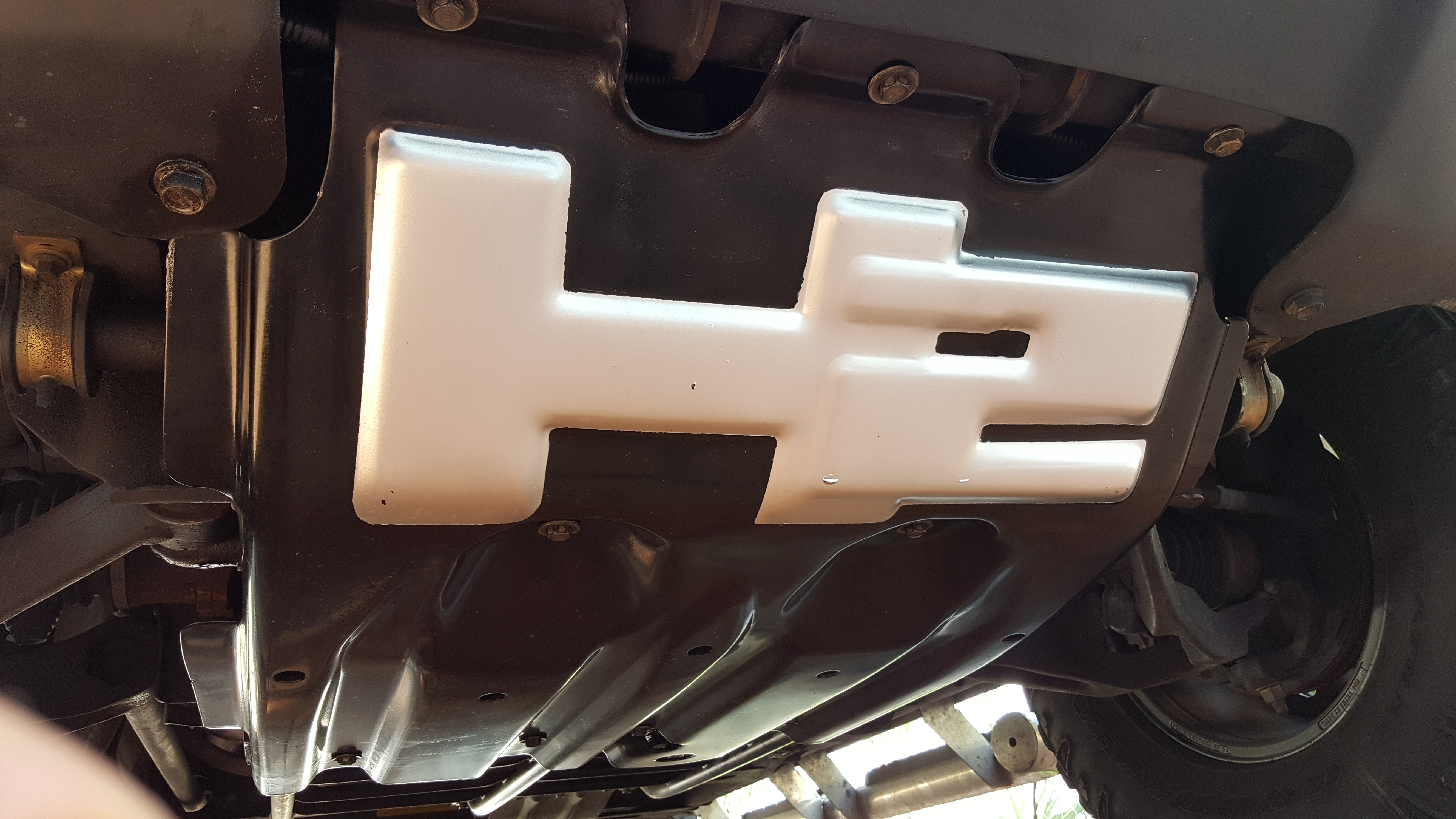

Yes I just find out how much pain in the a$$ was the skid plate .
For years my H2 was making funny noises as squirrels when hit a bump , also got a very annoying vibration
I remove the PIA for some issues with a hose leak then decided to keep it off for a few days to check the leak ... BINGO all the noises , vibrations and more
disappeared . it rides much different
NOw Im dealing with install it back adding some rubber as an insulation for noise and vibration ... Get a different aftermaket ( havent shop yet)
Or just keep it off ( rather not . I like how it looks )
Does any one had any idea what could works
BTW I read in many forums how big pain are those skid plates but never realized that was a real problem ... Those M.F looks so innocents ..I really hate it . It keep me mad in every ride for years . I couldn't never adjust and forget the noise or vibration

Was it just rusting around the fixture holes ? what was causing the vibration ?

Can't said what was causing the problems. Only found 1 screw on the front left which was lose other than that it looks perfect.

Powder coated the PIA . Painted gray the H2 logo and fixed the loose screw
Well seems the screw was the issue with the noise and 90% of the vibration
It rides better without the skid plate but not too bad after fixed and tight all screws
Resume .. if you have squirrel when going over bumpers noises and or vibrations check and re-tight all the SP screws

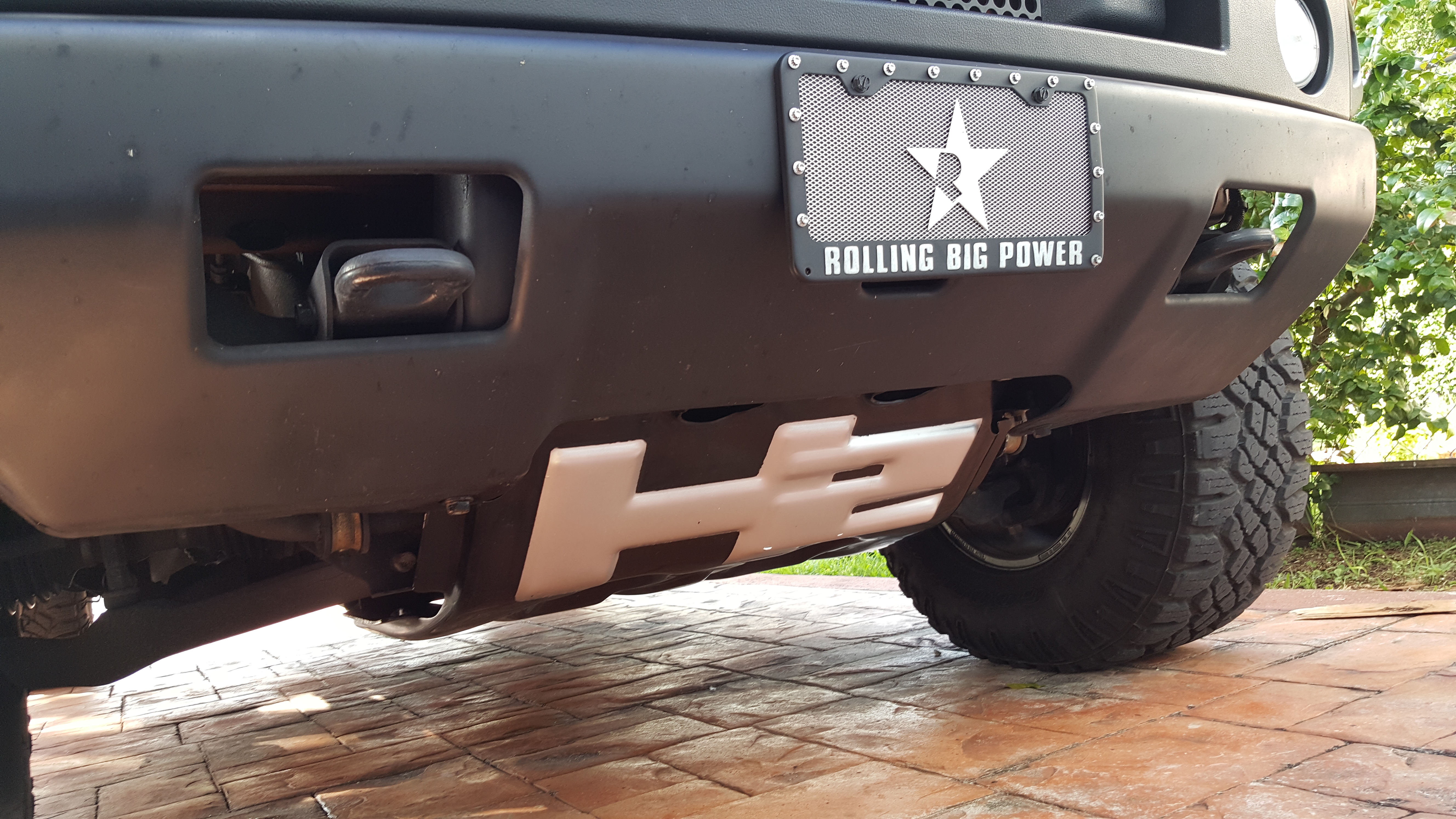

Looks clean now .. I really like it black much better than silver ... I had it plastic dip before so not a big change after painted in black

Looking good. Is it simple to get off ? I mean is it just 8-9 bolts and that's it ? Am thinking of getting mine powdercoated here. Still think i prefer the grey/silver look though. I like yours black as it matches your lower apron.
