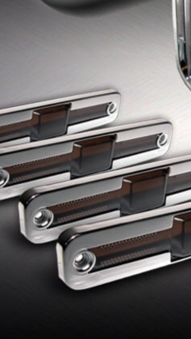

I purchased these from ebay. I tried installing. I am not sure how they work but they don't seem to cover the covers.

Hi! I'm not sure if those are the correct ones, is that a Chevy bowtie cutout? But if they are correct, you remove the screws holding the side maker on your rig, then place the cover over the light, and reinstall the screws, repeat 3 more times, simple as that!

That's what I thought. They don't fit!

I installed that same kit a few weeks ago. I removed the side marker lights, then cut off the old plastic housing so I had the circuit board exposed, still had plastic housing on the backside of the circuit board where the wire connects. then I used masking tape to tape it to the new smoked lens, then put the lens cover over the lens once you have everything taped well.

They look like the ones I bought off of Amazon. I had no issues with fitment. They just sit on top of the marker lights and are held on with the existing two screws.

I got the front changed. I believe the covers for the side will have to be cut to work.
