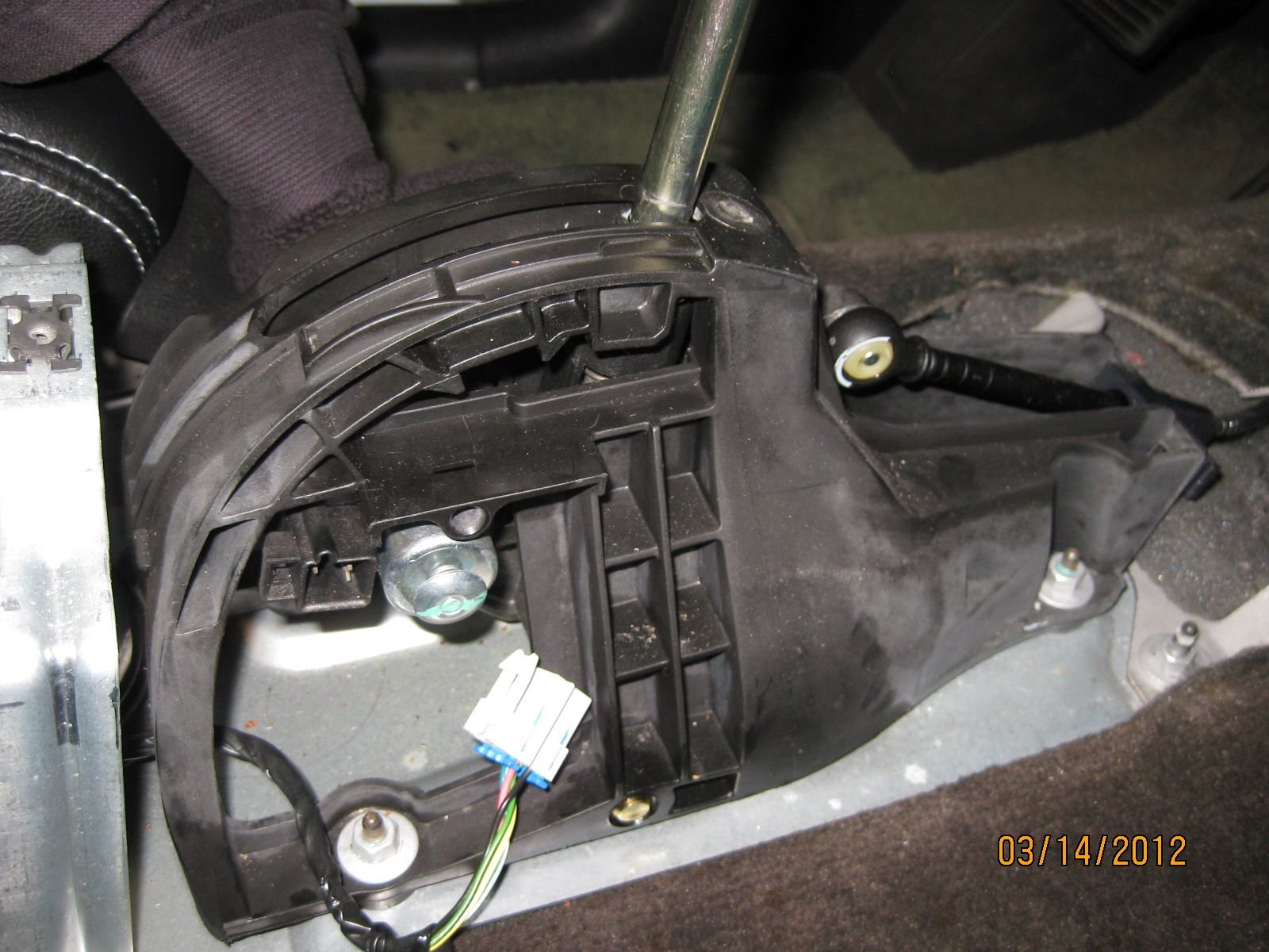

Hi guys,
Today I was installing my cobra in to the dash, and when I finished, I saw all my shifter cables cutted or out of their position. Looks like the previous owner had this issue before, so 3 cables are just unplugged and the pink and green are the only ones I know the position. Do you have a picture of this connector working fine or pin diagram?
This is the connector I'm looking forFor now, I'm just driing without the shifter cover, but I want to fix it and extend the cables to avoid this problem in the future. Any help will be appreciated.
Martin

Pin
Wire Color
Circuit No.
Function
A
BLK
1050
Ground
B
LT GRN /BLK
584
Park Lock Control Solenoid Supply Voltage
C
YEL
1996
Remote Shift Selector Signal
D
Not Used
E
DK GRN /WHT
1135
A/T Shift Lock Control Solenoid Supply Voltage
F
PNK
1020
Ignition 0 Voltage

Thank you Tharber!! I got to test and everything is working fine. I just need to tied better the cables and test a little more to close everything and come back to normal.
Martin
