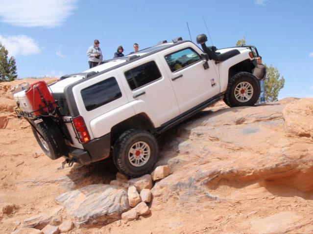

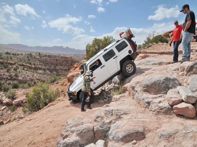

I tried those for awhile and it changes the balance of the vehicle. It shifts more weight forward so the rear is not as balanced. Sort of the drag racer stance to keep the front end down but then you need to add traction bars for that. If you load down for traveling and camping or add passengers it may help the reaction you are getting but increased different angle of the shackles will eventually flatten your springs due to the leverage and angle pushing down on the end. It will even cause the spring pack to arch apart after some heavy offroading.
It may add some more drop in the suspension but at the wrong time may be a problem in stability. It is a good idea to check full droop of your ABS brake lines running shackles. This will also allow stock shocks to top out or over extend reducing the quality of the ride and life of the shock. Like alot of things, it's a trade off for not much gain. Just my opinion after trying it for awhile on my 06. I did not do this to the Alpha after learning that.
The add a leaf or just a rearching of the springs is the better way to go. I don't think it is necessary for my type of wheeling.
Attached Thumbnails Shackle lift causing a bounce when braking-9816s_resize.jpg   Shackle lift causing a bounce when braking-6x5327.jpg   Shackle lift causing a bounce when braking-6x0196.jpg

Thanks for passing along the pics. Your right your spring is much more flatter than mine. I guess I will just have to invest in the a true suspension lift. Any other options besides Rancho 4 inch?
