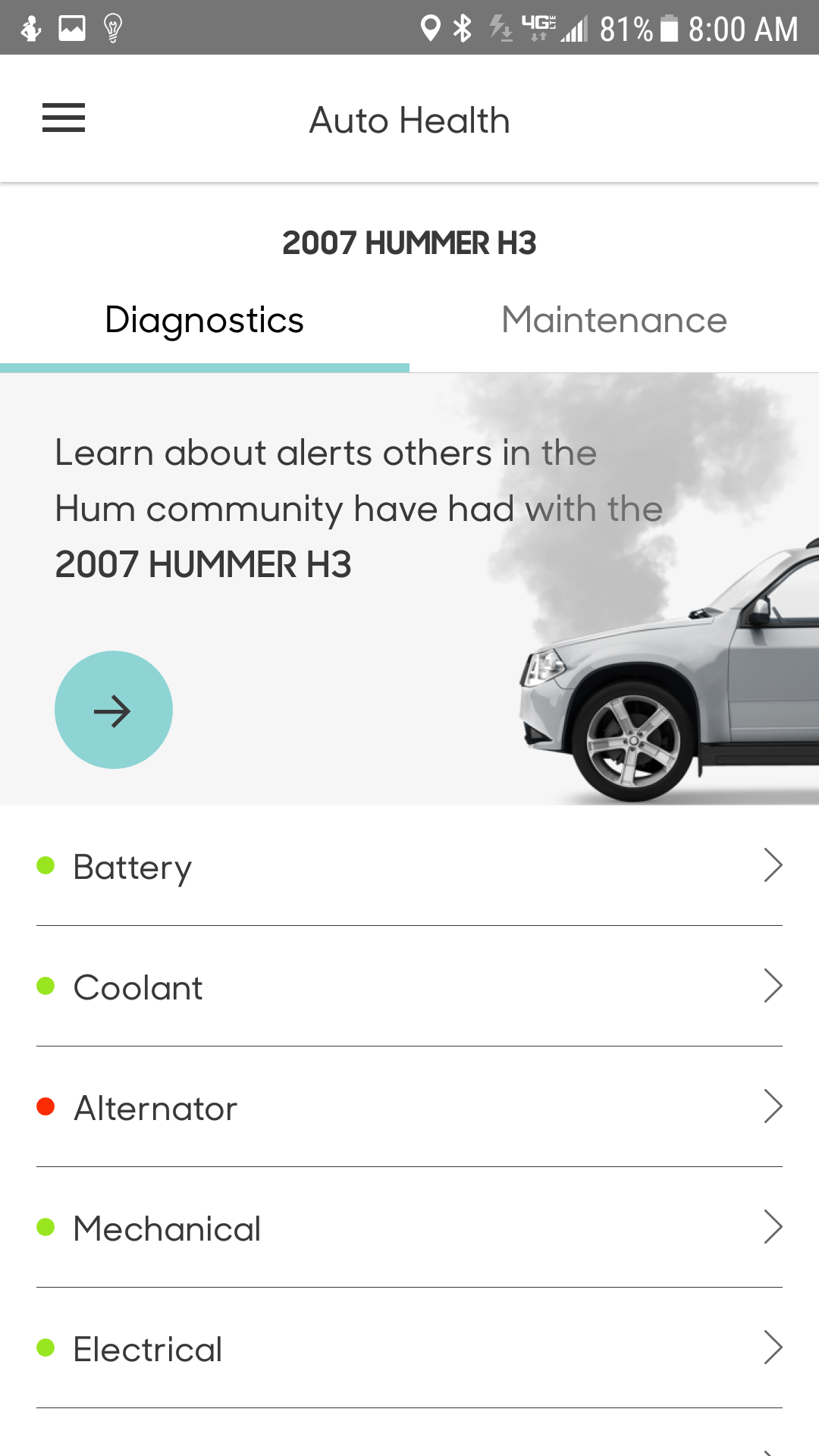

End up dropping it a at repair shop last night. They called this morning and said the alternator is bad. My HUM ODB reader also confirms alternator is bad and battery is good
