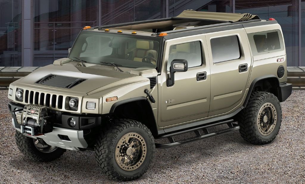

I've not seen one of the factory ones come up for sale since I bought my H2 earlier this year.... nor really any of the Gobi's either (at least for under a grand) for that matter. And I have been looking.
Gobi does make one that installs behind the sunroof also. They have several configurations available. None are very cheap though. Check the Gobi site and you can see the different options they offer.
Below is what the factory option one looks like (looks to be installed a bit far forward in this pic). I've also though the factory optional one is almost too tall but I still kinda like it though. If you are big on using the sunroof the other pic would be a nifty feature to have. It was a concept special edition 2007 (would have been a 2008 model) - not sure if any every actually got made other than the concept one though. Would also pretty much negate having a roof basket of any type as well.

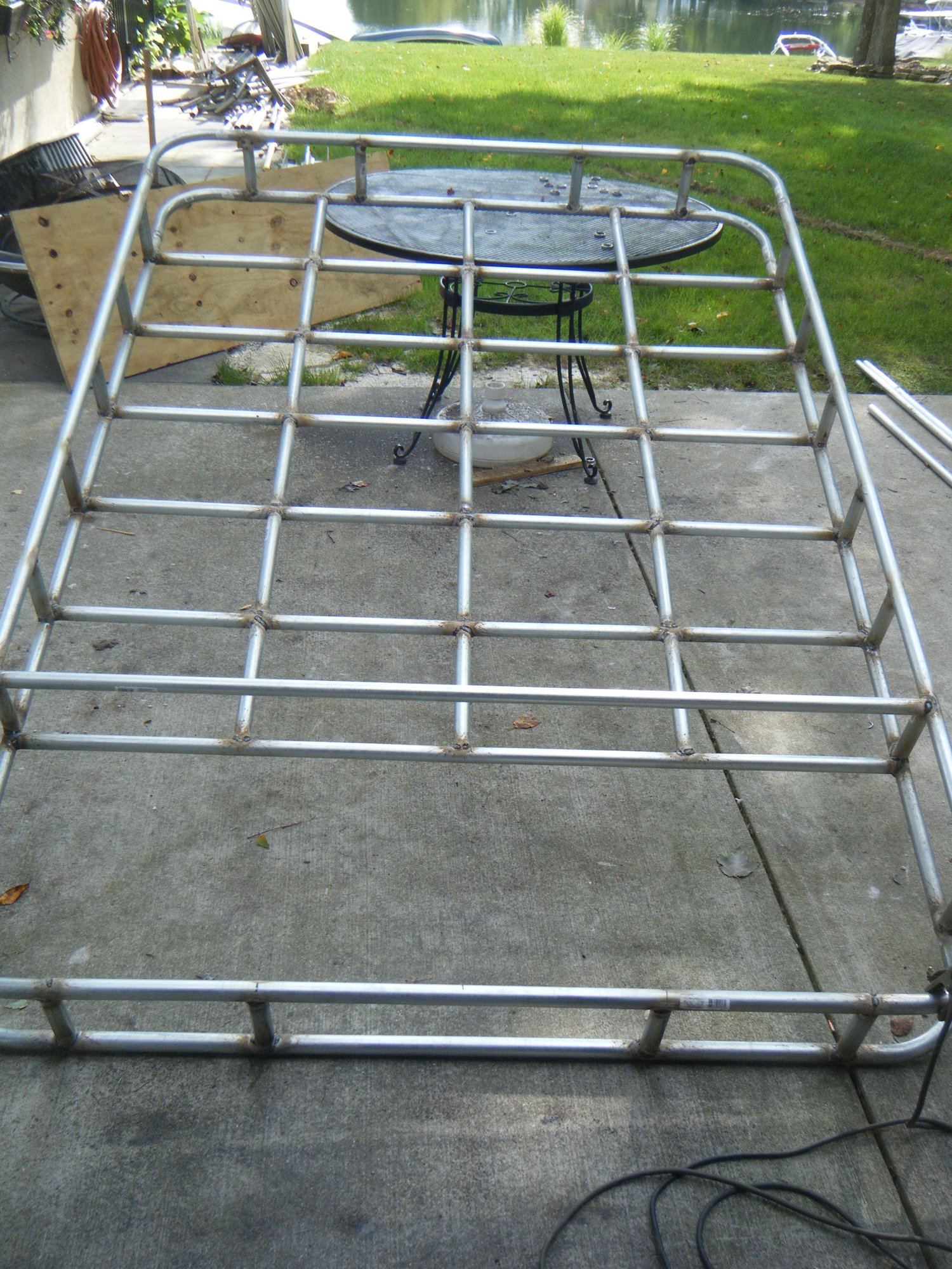

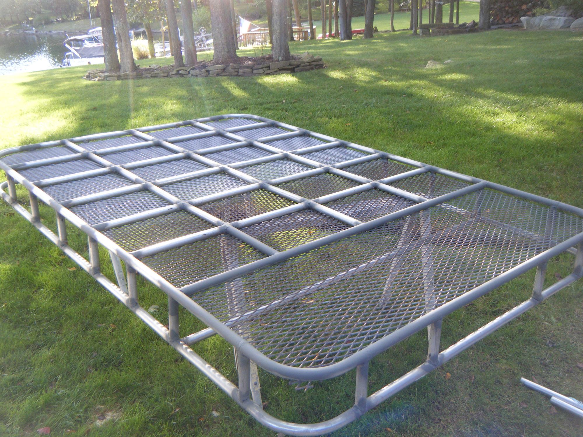

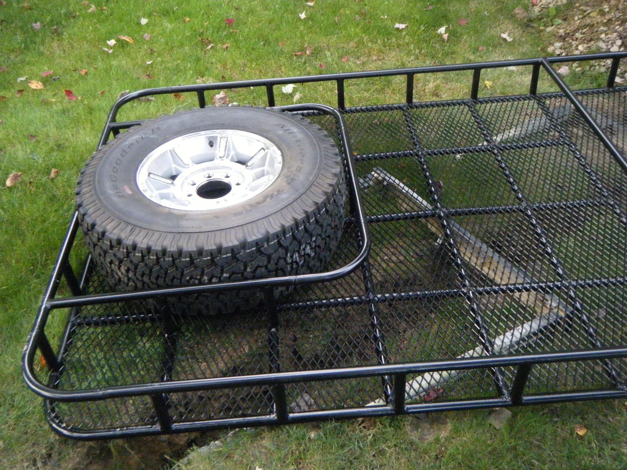

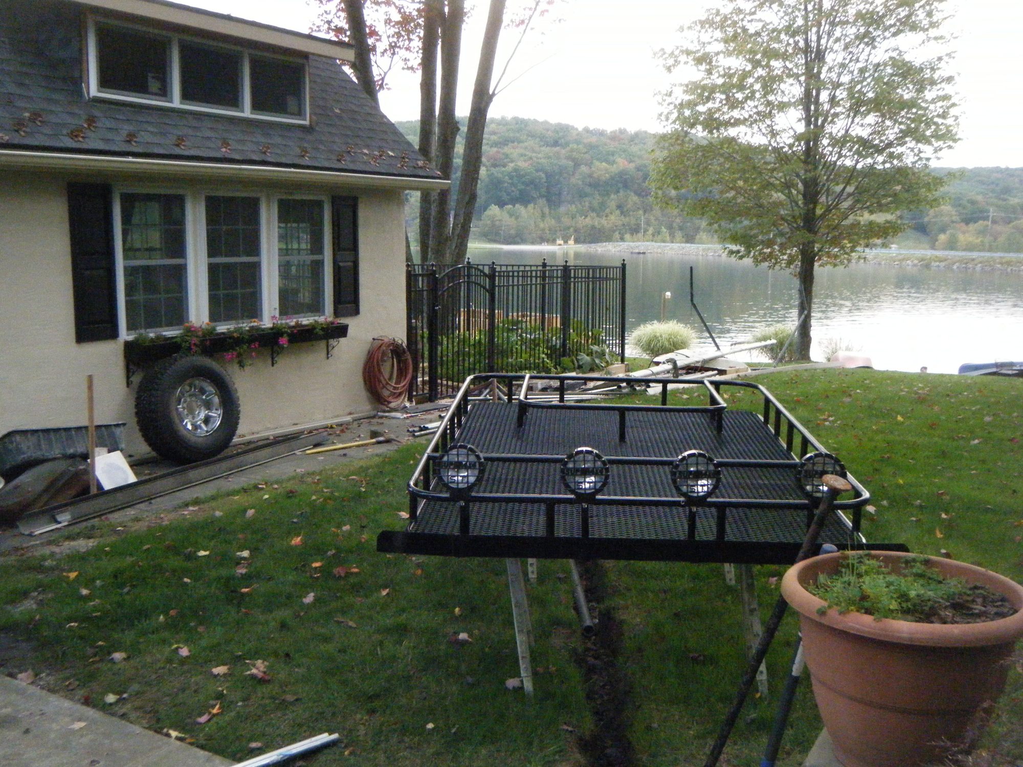

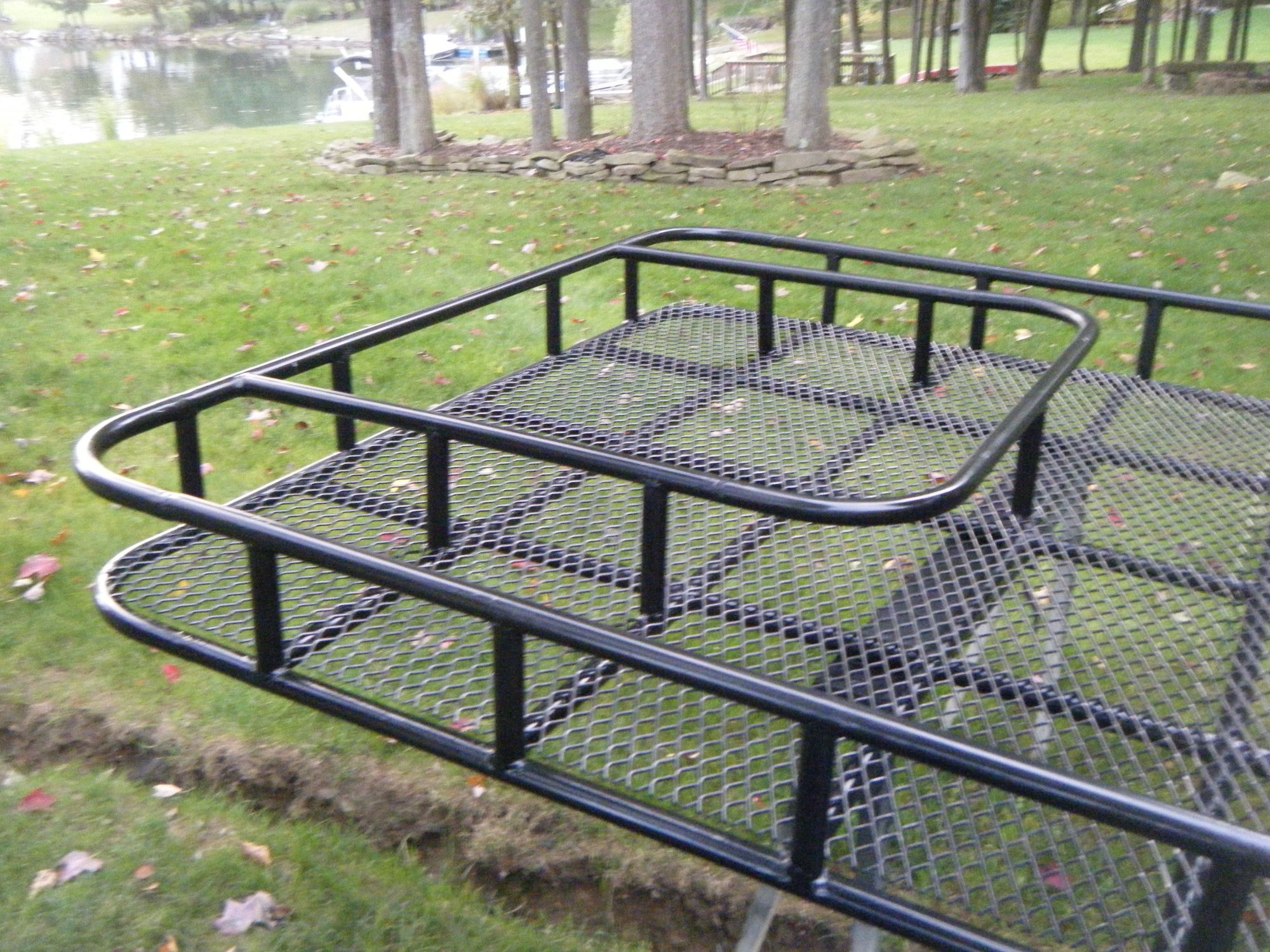

OEM is a nice rack but there just don't seem to be any around and when they are the guys want 2k-3k for them!
I had a Gobi ordered at $1600 and the dealer then couldn't get it for me. Gobi is notoriously 2-3 months lead time and terrible to deal with. I ended up getting my money refunded and built my own. It's not quite done yet. It will still get a ladder on the back, tire mount, shovel holder and tool boxes. Maybe a raised tent platform attachment. Building one yourself is doable but it takes a lot of time. If I was going to do it over I'd have it powder coated rather than painting it and I'd make it a little longer. It's made from 1" galvanized conduit so it's still pretty light weight 130lbs. I have 300-400 dollars into it.

That looks great. Are you doing a ladder too ?
