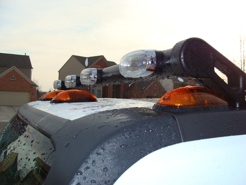

I made my own. $100

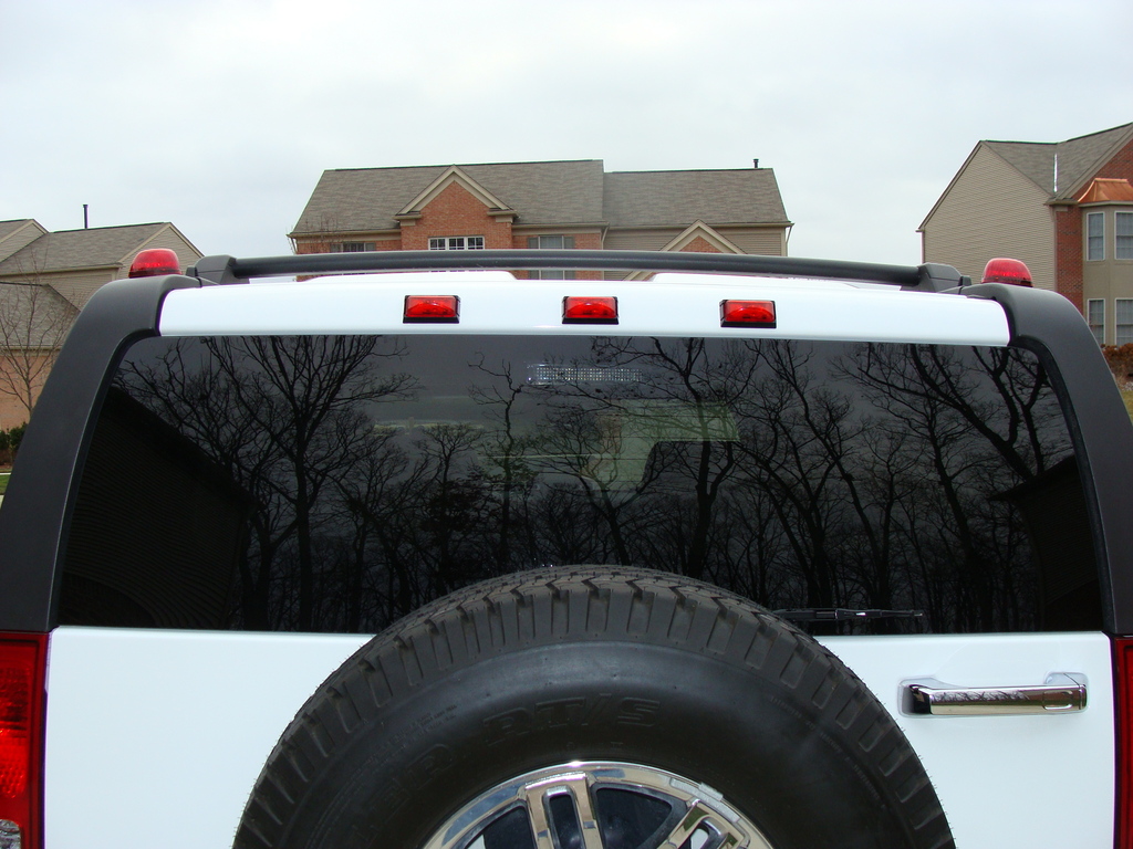

Made my own rears too.
https://www.hummerforums.com/forum/h...-lights-21911/

Halo, he currently has the OffRoad lights as stated in his original post.
He will have to fill the Riv-nut holes and paint in order to perform your mod.
I believe hayitstyler is thinking it will be an easy swap not knowing that the clearance lights are very expensive, no longer produced and very hard to come by. He will also have to rewire the lights if he can find a pair to work with the driving lights.

I was thinking he could possibly mount the individual lights on top of, or behind the OEM offroad trim pieces. Don't know how the spacing would work out with the offroad lamps?

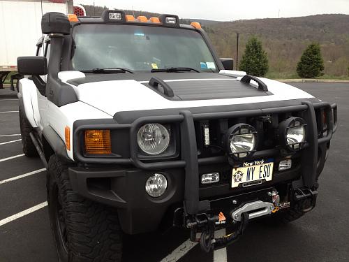

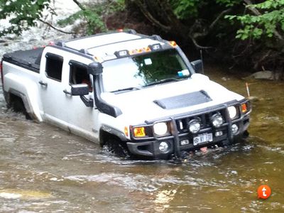

If you already have the OffRoad lights you can do this too. A buddy of mine on clubhummeroffroad.com did this and I think it loos great. Even up close.
Removal of the A pillar trim is very easy. Open the door, Remove the 2 Phillips screws, pop the hood and gently pull up on the engine vent (fake air cleaner). Make sure you don't smash the hood with the vent. Then gently pull on the trim. you have enough room to run multiple smaller gauge wires under the a pillar trim.

That helped a lot man thanks. And yes that look very good. I think I am going to do that now!
