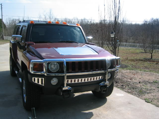

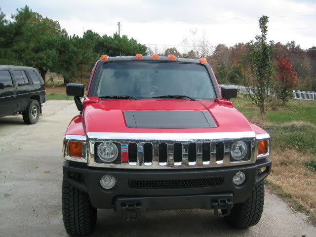

Old Feb 26, 2007 | 11:04 PM
kild1's Avatar
Joined: Dec 2006
Posts: 852
Default RE: Roof Marker Lamps - The final Call
old kind
new kind
