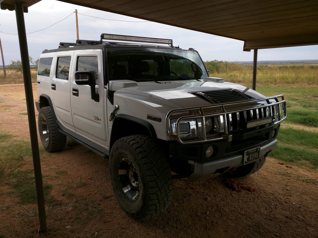

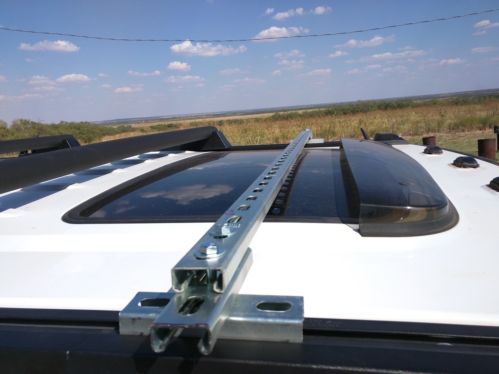

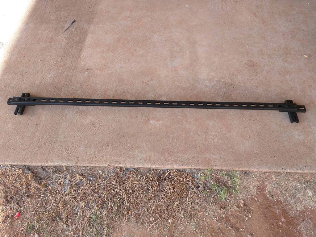

Took Diesel's advice and used the superstrut. Because of the way the sunroof bows out I had to use some other superstrut to raise it up a few inches so the bar didnt rest on the glass. Then I just painted it with bedliner. The superstrut is mounted inside the roof rail with a simple nut and fender washer. It can be slid along the railing just by loosening/tightening the bolt.

Sweet, that looks great!
Steve

Turned out nice!
