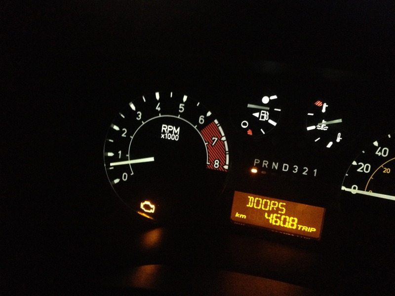

I am just doing a search on how to fix my light on my dash and came to here.
This is the light I have, it came on a little while ago (may be 1500km ago), but has once gone out for a few days and then came back on. I checked the engine bay but have come up with nothing that looked out of place.
Just wondering if this is the light people are talking about?? How do I fix it??? I am about 700km away from an authorised dealer, so that is not an option. Hummer is running fine and has not missed a beat, so not sure what the issue is.
Seems like a bit of a BS thing to me, hope this will not keep happening as the car gets older, or I will just rip the light bulb out.

Any auto repair shop with an OBD 2 reader can read the code and tell you what is causing the check engine light to illuminate. In the US, most auto parts stores will do that for you also. OBD 2 is pretty much the universal standard so there should be plenty around. Good Luck.

Ok, thanks, I am only 100km from a mechanical workshop, so I should be able to get them to have a look at it next time I head into town for some shopping, will the OBD 2 tell me the actual problem or will it just give a fault code that then needs to be translated??

Dependent upon the reader. Some will just give numbers and others will text of the code. An internet search can easily translate the code if just a number is given.

lol i thought this was a joke when i first read it lol. could be something minor like a bad oxygen sensor or a loose gas cap. in my experience pulling the ECM fuse will clear the check engine light. If it comes on again get it scanned.
