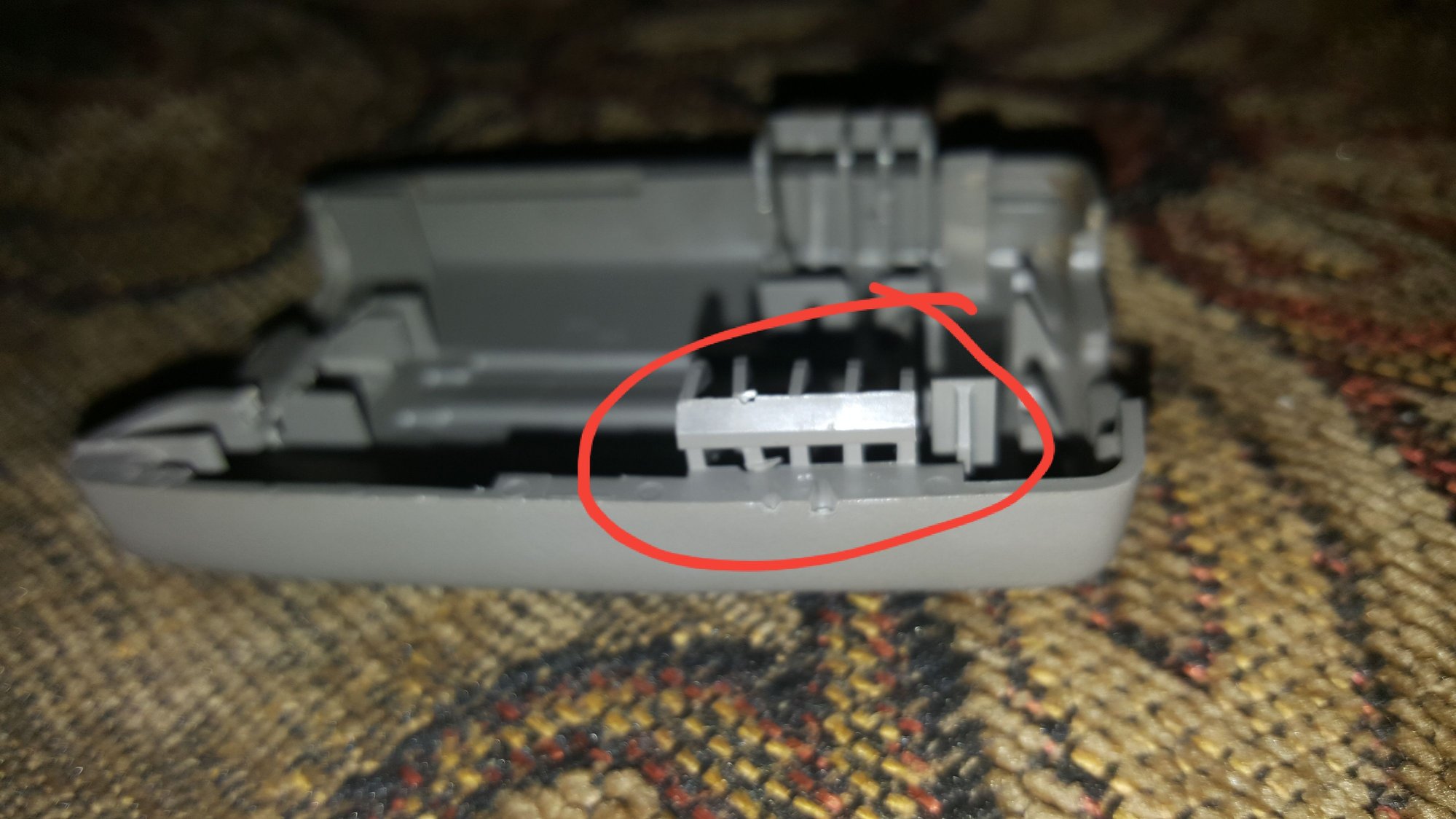

Update on this if anyone has the same problem in the future... The plastic covers are the same in a lot of GM vehicles, no need to buy the entire apparatus from GM just to replace the covers. I found very similar colored rear seat buckle covers in a trail blazer at a junk yard. If you take an ice pick and poke into the large side near the bottom (see photo) they will pop apart. Snapped the trail blazer covers into the rear buckles of my H2. Looks pretty good! The broken ones looked like sh*t and the jagged plastic was sharp.
