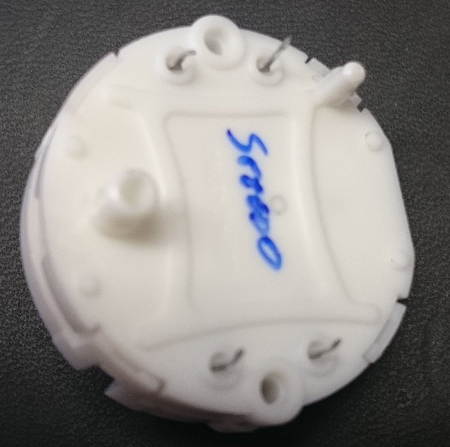

Yes steppers were easy to replace. The instruction I got were pretty thorough and comprehensive.
For me it was the speedometer that was sticking occasionally, I tried turning the motor shaft with pliers, it really was binding, I'm amazed it even functioned at all.
How cheaply made the motors are!
